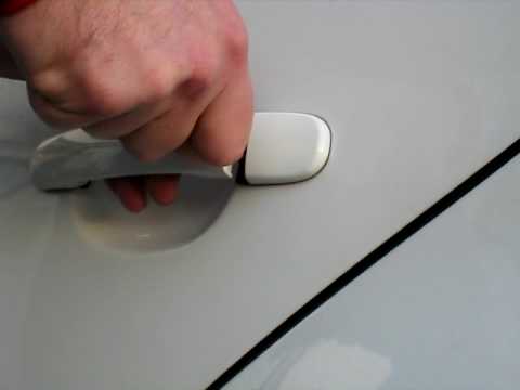

          I gave this a try with a thin piece of wire. Worked with the 2nd latch, but not the 1st. Hopefully it'll save me some labour costs the next time I visit the dealer.
