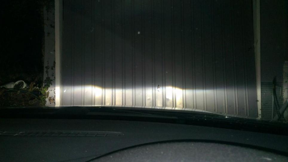

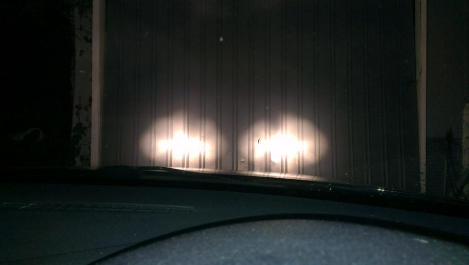

                      Snapped these, excuse the phone pics.
                      Low beam:
                      High beam:
                      This was about 2-3m from the door, driveway is on a mean slope so ignore the height/angle of the lights.
                      Can anyone compare to their mk4 golf? Ideally a r32

                        my gti doesnt look that ****..
