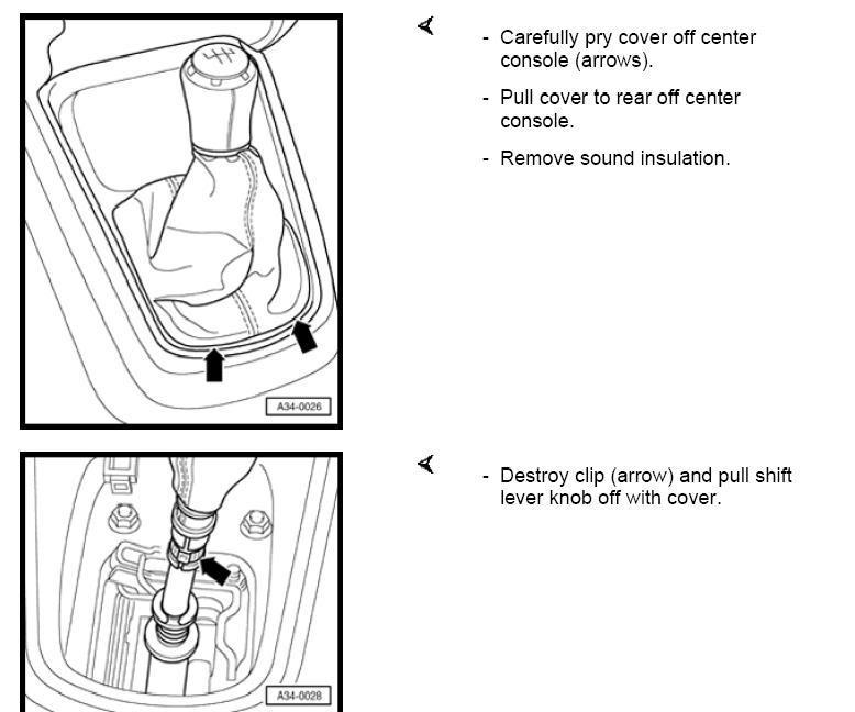

I would like to replace the gear knob on my Bora V5. I have tried twisting it off anti-clockwise but the whole boot moves with the actual gear knob. Is there a trick to it that can be explained to me?
Cheers Matt
