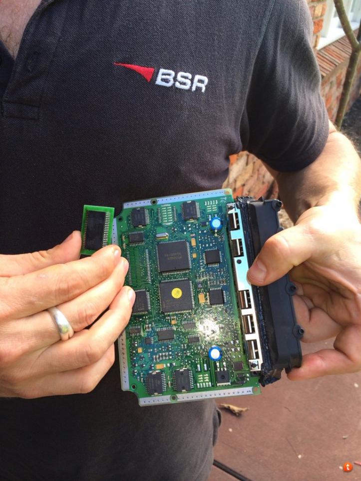

                    WOW!!! Just drove to work with the new Chip....... It is a completely different car... It's a little monster!!!!
                    Guys gotta throw a shout out to Cameron @ BSR the chip is brilliant and for under $800 installed I can't argue, service was top notch and the car feels amazing!

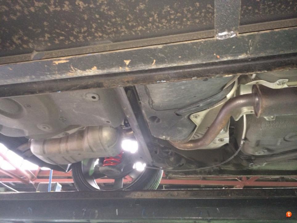

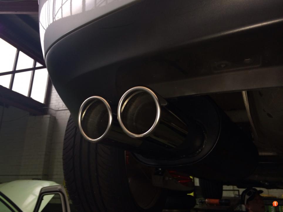

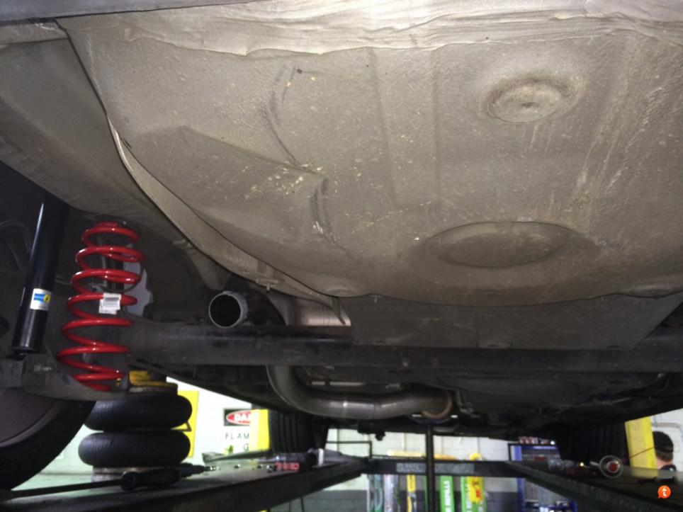

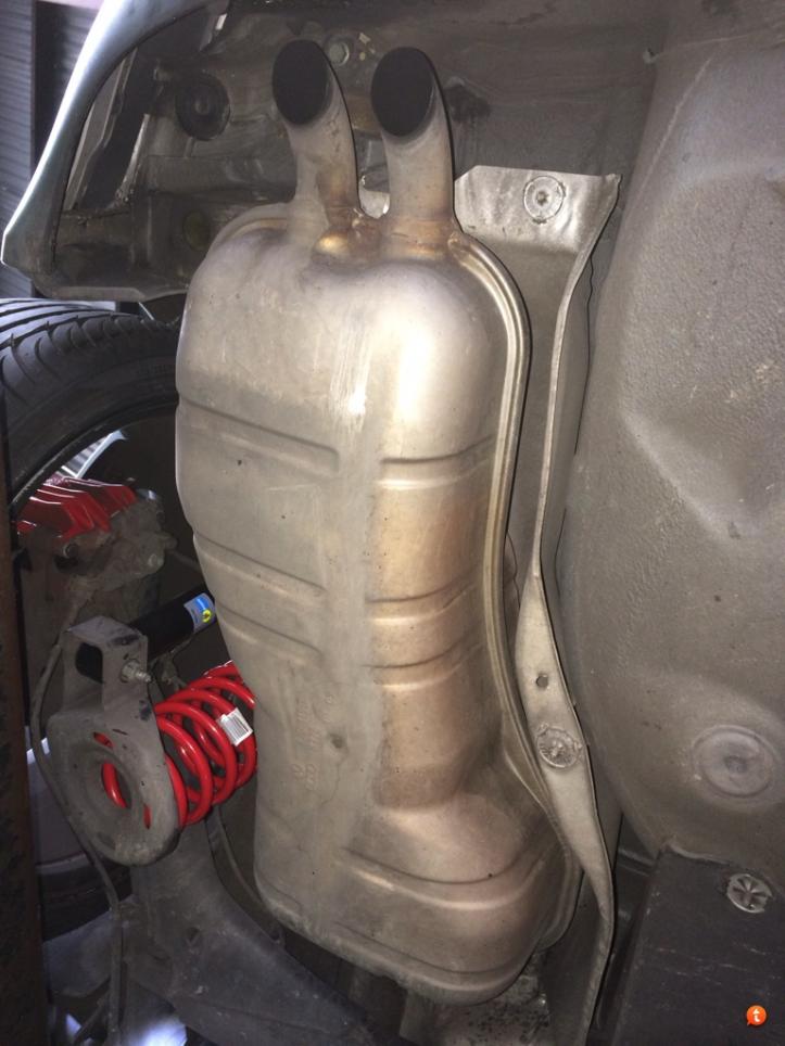

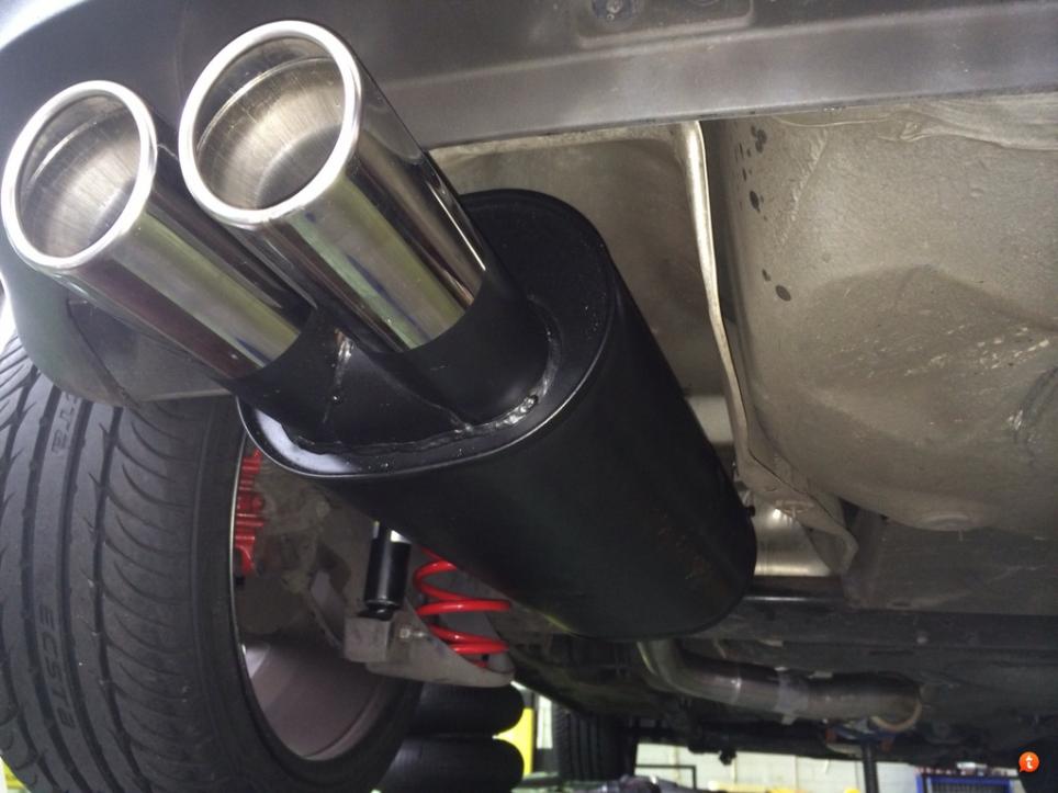

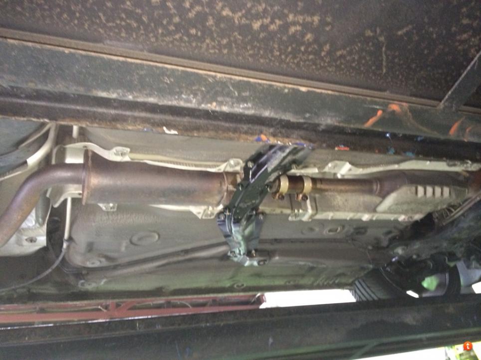

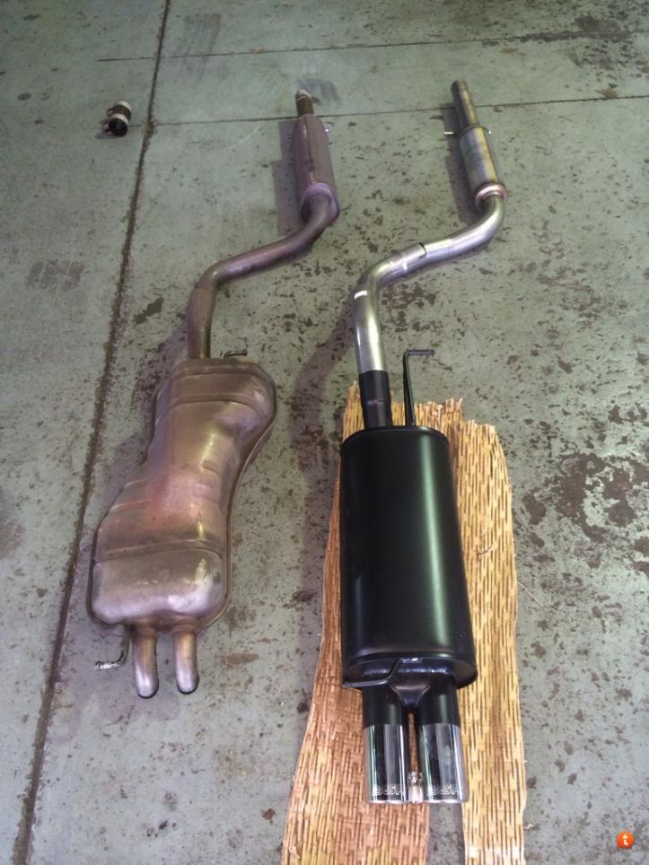

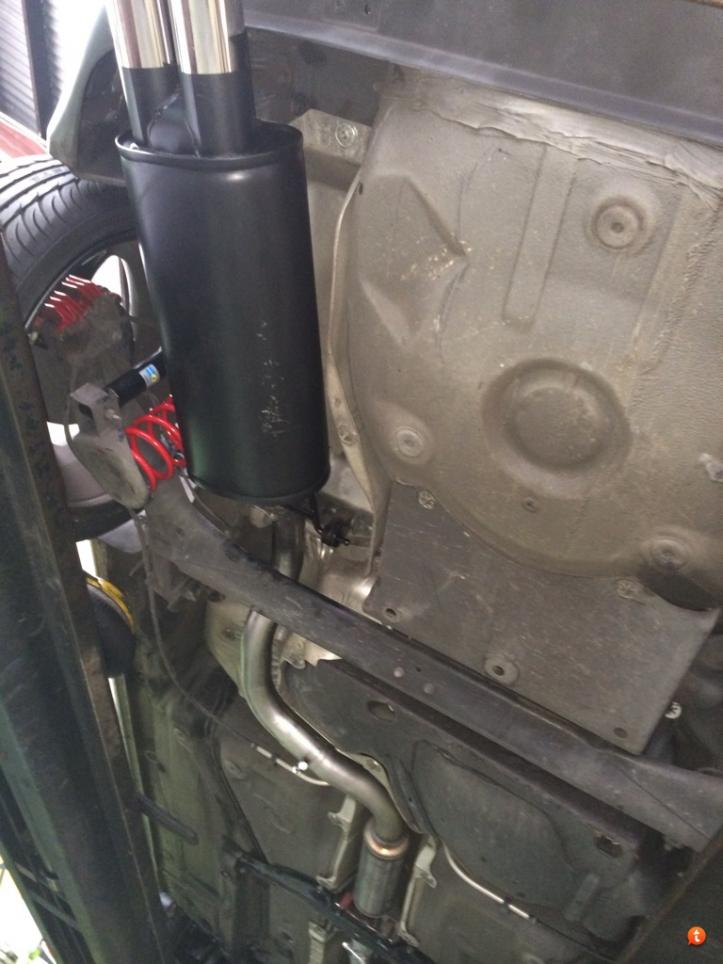

                      So did the exhaust on Sunday with the help of mates workshop, made the job a lot easier that's for certain!
                      Got a bit more grunt and it sounds amazing. I'll pop a video up shortly but here's some pics for now.

                            it's a 2.5" BSR sport flow cat back system sounds brilliant! It only cost $550 and when I get the cash I'll probably go for the 42DD Downpipe to match it costs about the same again.
