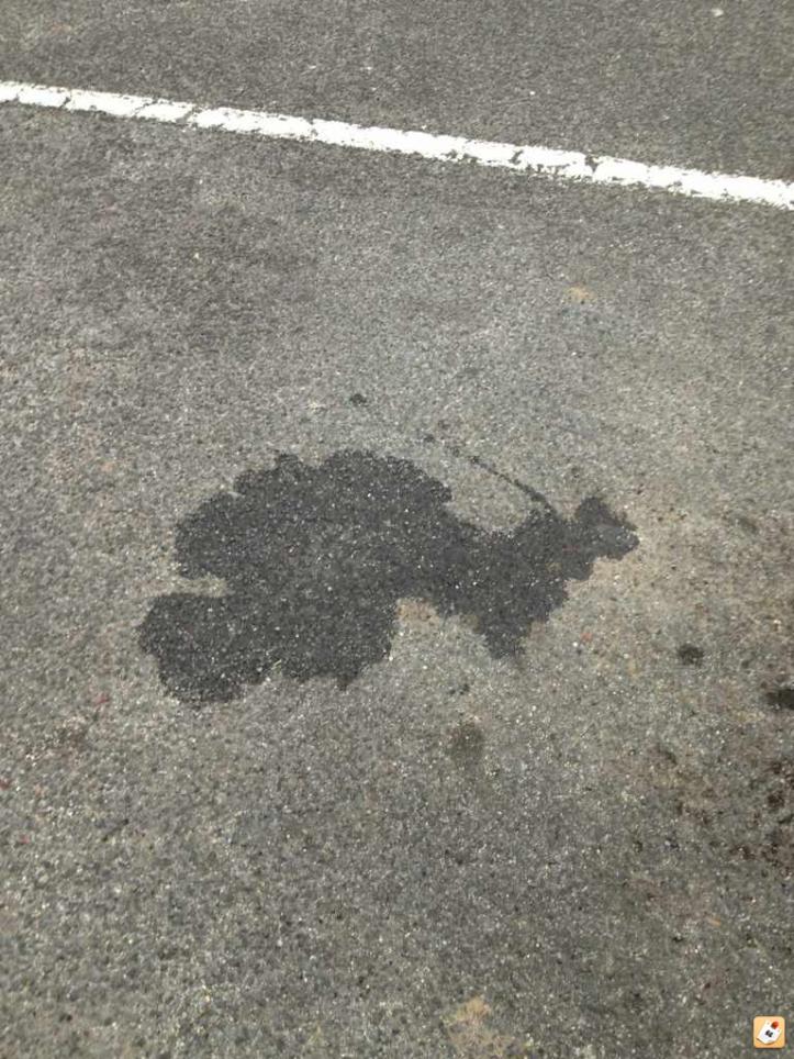

    Alrighty, 1700 Kms into our road trip everything working well engine is sounding good gearbox is performing well. Can be a little noises in first start up with cold oil, but that quickly passes.
    Ok so was raining today heavy, we drive through it and stopped about an hour later. I notices a serious amount of water dropping from below the car far back in the engine bay I don't have the plastic plate under the engine any more.
    It's defo water no levels are down, ( tasted like water) I think soy d deadening material on the bulkhead was just draining its self?

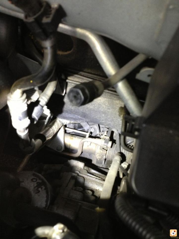

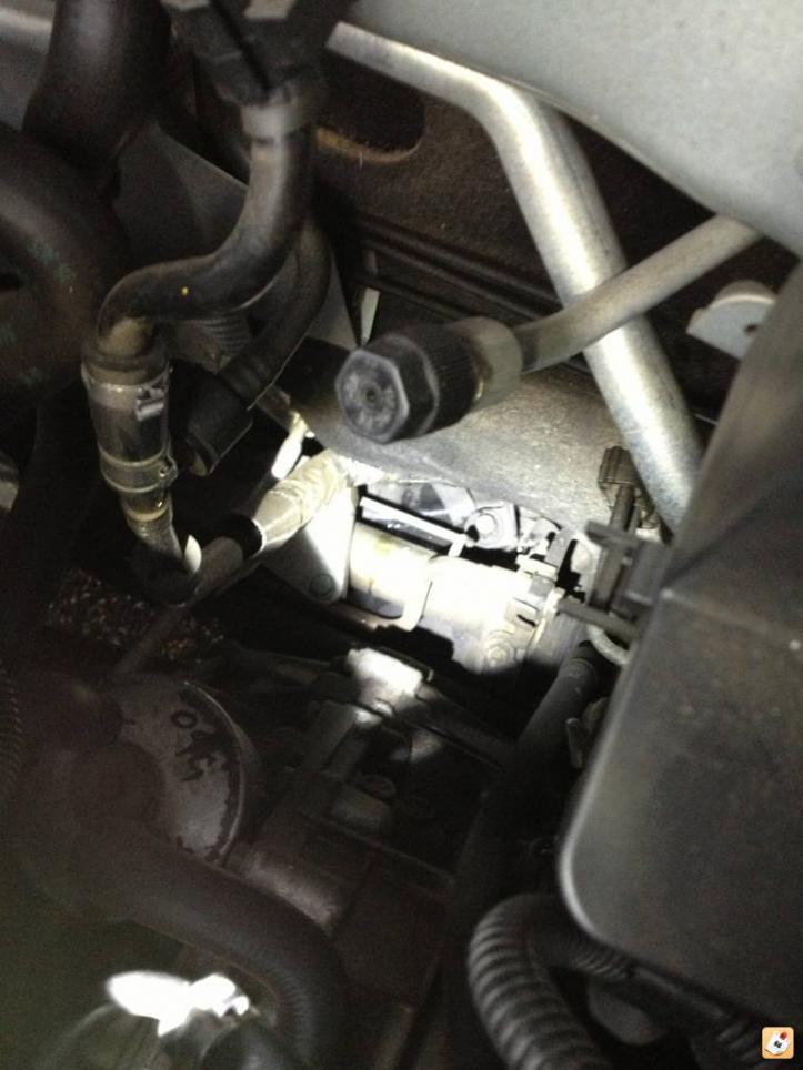

            Aye m8 just reading about this.. Could be the shout , just that it weird that its dumping liquid onto components under the car, rather than just straight onto the deck it's hard to make out.
            It's dripping onto the metal cross member featured at the center of the pic. ( above the s shaped price of pipe)
            Surely if somthing had been designed to vent. It would do so to an appropriate place?
