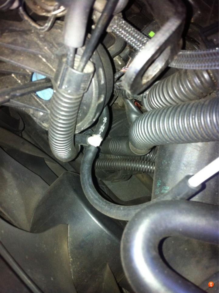

                      Here's a pic where it's connected using T piece. It will keep exhaust tone down while driving normally.
                        Thanks so much for posting that grtuned!! You are legend!
                        I'm going to hopefully follow suit this weekend and quieten the exhaust down for the time being.
                        Just to confirm, where the vacuum line you plumbed into start and finish?
                        I'm looking at fitting an electronically controlled air flow solenoid that could allow the vacuum line to the exhaust flapper to be controlled - i.e. open vacuum line to flapper to restrict noise under 4000rpm or turn off the vacuum and have the flapper fully open for full noise.

                          how did u run the vacuum line all the way back to the rear? under the car or inside the cabin to the boot?
                            Fitting an R32 exhaust on a Bora WITH Oettinger rear bumper - yes, I have sea...
                            Yeah that's right connect T piece into existing vacuum line you cant get it wrong then run line to flapper. I used flexible hose at both ends and used hard type plastic vacuum hose to connect the two together. You can see white hose in pic!!
