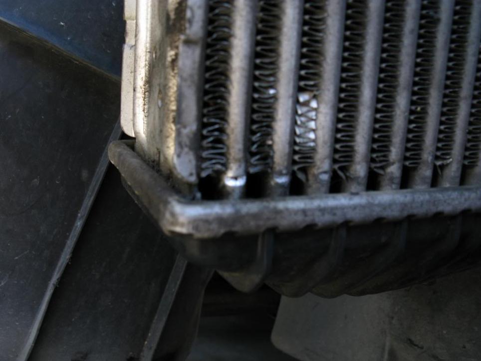

          Farout my intercooler has a hole in one of the vents... Does anyone have any recommendations on how to fix this? Or is it best to source a 2nd hand one. I don't want to buy a front mount just yet. Id rather stay with my side mount for financial reasons atm.

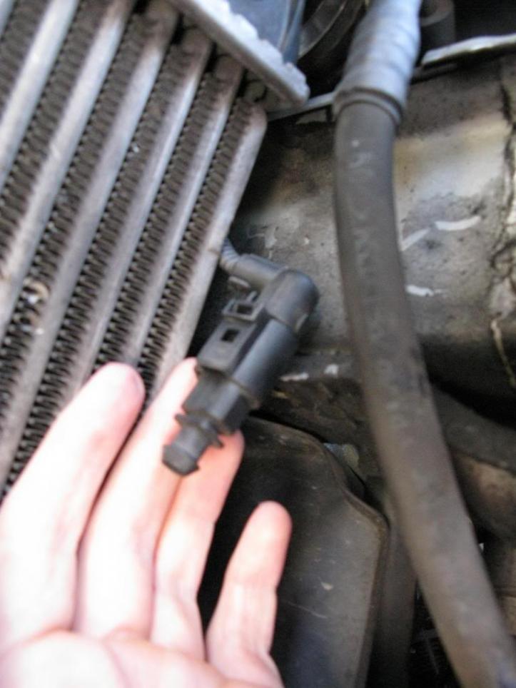

          Also this connector was hanging down the side of the intercooler... its not a vacuum hose.. anyone know where it is meant to go?

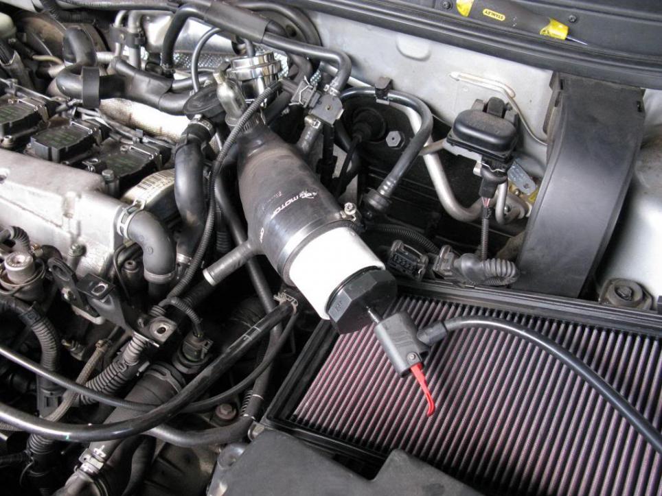

            For anyone that is curious about the boost leak tester... This is hooked up to my bike pump, but you could also get an attachment to hook up to a spare tyre, or even change the nozzle to fit onto a compressor...
              Clean with brake cleaner and araldite it up.
                Thanks Gav
                I will get some Permatex Cold Weld from super cheap and some brake cleaner.

                  I'd google the part number on the sensor. It doesn't look like the outside temo sensor, but it might be?
                    That random connector is just a random connector.
                    It should be positioned behind the driver side head light. There is a clip for it.
                    It does exactly nothing. If you pull off the end piece you will find it is nothing but a piece of plastic just to keep water out of the electrical connector. There is voltage in it however.
                    I think it might be for the MAP sensor on the intercooler, which we don't have.
                      Looks great! Do you have a pic of all the individual parts you got from bunnings to make it? Did you block the other end going into the throttle body too?
                      Also, I have a spare SMIC after just installing my FMIC..
                      PS - That Wiring/Plug goes to nothing on my GTI/1.8T too..

                        Thanks for the heads up on that wiring plug, I was trawling etka last night going insane. Ill just let it hang.
                        I can take close up pics of it tonight, but honestly it is not very sophisticated.
                        - 50mm threaded piece of PVC (Thread goes about half way down)
                        - 50mm matching threaded cap
                        - 1x Air connector of choice, I used a schrauder bike valve which required me to use a 8.5mm drill bit to drill a hole. (Exact fitment). I left the harder more durable piece of rubber around the base of the valve.
                        - 1x roll of plumbers tape to wrap around the main thread of the 50mm threaded cap.
                        - Glue the valve onto the threaded cap with loctite, cold weld, whatever you like, aslong as it does not leak. (i used loctite on this occasion.
                        • Insert the newly constructed boost leak tester into the intake pipe.
                        • Remove the PCV valve from the TIP and plumb the hole with something. (I used a c02 canister as in picture). If you dont do this, apparently it pushes oil into the TIP and you will be blowing smoke afterwards.
                        • Remove the oil cap from the top of the engine.
                        No need to block off anywhere else. Start pumping with your bike pipe and listen for the dreaded hissing noises haha
                        If using a compressor start at 5 psi, because its pretty darn obvious when you have a leak. If its ok at 5psi, then keep raising it up to what is normal boost for your engine. If its holding that pressure fairly well, then you should be all good!
                        I used this page and youtube video for inspiration...
                        Stealth 316 - Intake pressure tester
                        http://www.google.com.au/url?sa=t&rc...55819444,d.dGI
                          Thanks for letting me know about your spare intercooler. I repaired mine last night with some epoxy weld, but if it doesn't work properly I will give you a PM and we can work out a deal. I haven't tested mine yet lol, apparently this epoxy weld is good for 4500psi.. so i don't think 20psi should be a problem. Will let you know.
