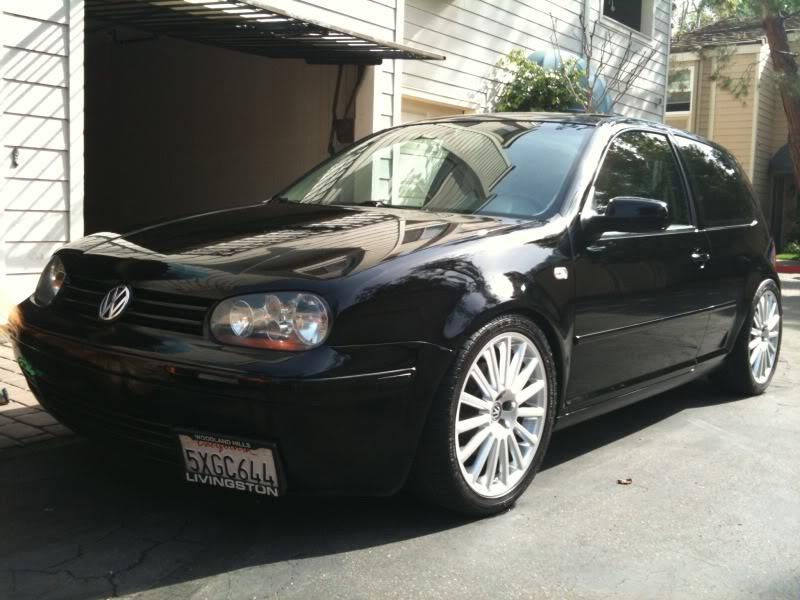

      Thanks Dylan, in that case a measurement on a non-R32 would be what I'm after.
      I've seen some wheels I like for my Polo which were on a few mk4 GTI's and they sat perfectly so if I know where the Ariosto's sit in relation I can get a good gauge of how they'll work on the Polo since I'm running Ariosto's on mine atm.

        Send me pics of them fitted up/face of them.

          Oh, i know the specs of the wheels.
          18x8.5j ET35 Front
          18x9.5j ET35 Rear
          What i need is a visual of a MK4 GTI on Aristo's (18x7.5 ET3 and the gap from wheel face to guard so i can get a comparison for the Polo. If the gap is pretty similar then i should be able to run the same specs on the Pog

            oh... well just use a offset calculator, it'll tell you how much more the wheel will sit out.
            off the top of my head front will sit out 15mm more, rear will sit out 27mm more then what you have now
