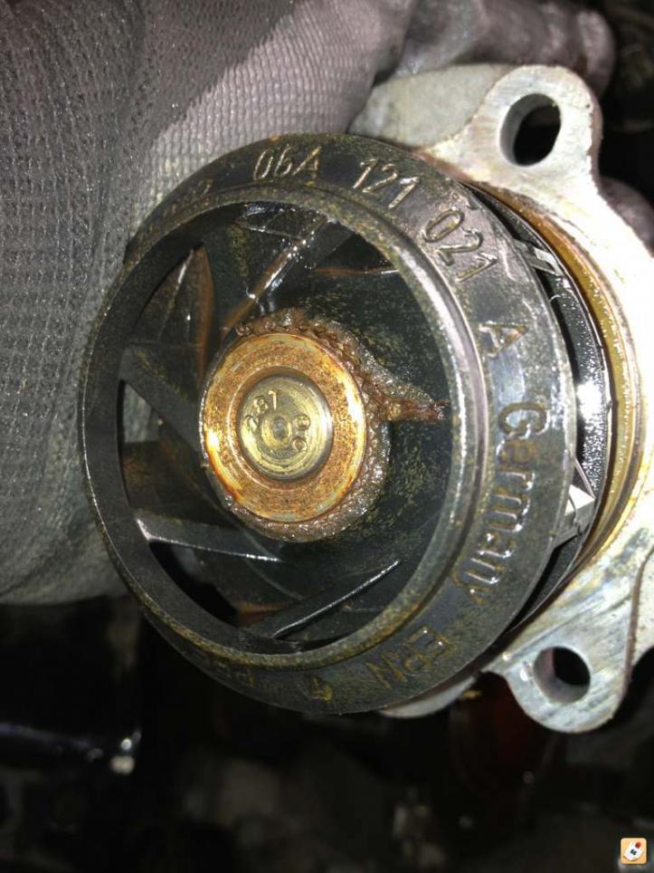

                  So I left work early today to take advantage of some sunshine... Floating impeller it is!
                  After taking out half of the engine bay, the water pump impeller is just happily spinning on the shaft!
                  Glad to confirm it as a replacement kit from ECS is already on the way!

                        Problem solved, thanks for the help all!
                        Replaced the blasted water pump along with timing belt, tensioner, guide, auxiliary belt and thermostat!
                        Bought the kit from ECS and was shipped in 4days!
                        Repaired it myself so I'm $1k up!
