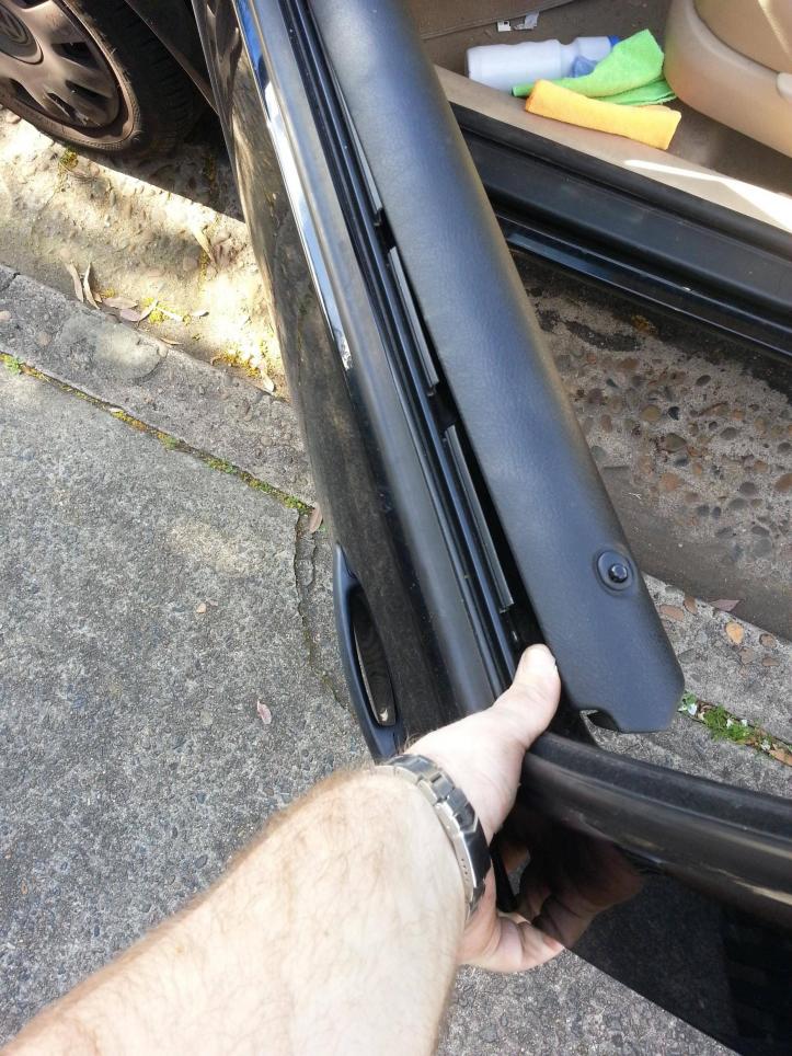

How do I secure these? Where to get clips?
The door card should be sitting in that channel, so you may need to remove the card to reinstall it properly. You could try and pop it back into place, but if you have a TORX driver it's only a few minutes to remove the door card.
There are locking clip on the back of the card that pop into the door. The card is also held in place by 6(?) screws, so it should be ok if you're missing a clip or two. If you're desperate, you will be able to order them from your dealer.79 MK1 GLD

you can usually get them back on by twisting the door card into the channel or as above remove the panel complete and slide it in there first then screw it on...window tinters always miss that channel when tinting and refitting! ...VDUB..VOLKSWAGEN TECHNICIAN - 16 YEARS OF PAIN..VCDS CODING- FAULT DIAGNOSIS - PRE PURCHASE INSPECTIONS- REPAIRS9W2 BT KITS -$300 - 9W7 BT KITS - $450 - CANBUS UPGRADE $150BRISBANE / GOLD COAST
