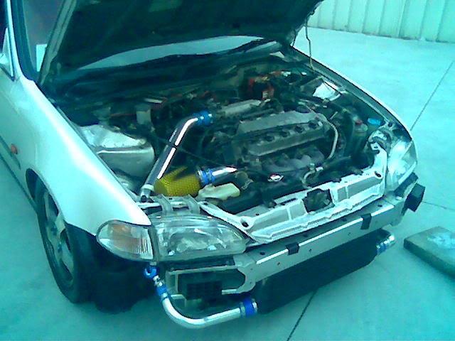

              Naa, that was my own doing.

                          Ah ok, never had that poblem, i ran only alum piping on the civic.
