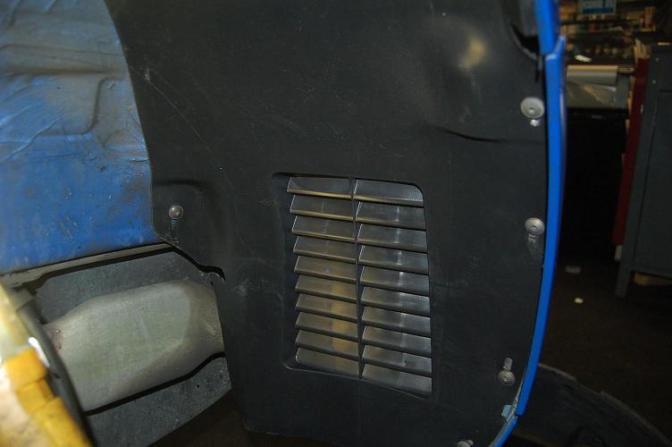

                A vented wheel arch liner will help some more air pass through the stock intercooler, I remember we did a group buy on here about 4 years ago and I got about 6 liners from Courtney (whiteVR6) and Seb (Bug_racer) at Euro Revolution, they were a good buy for around $75 each. The VW part number was 1JM 809 962 A
                They may even have one or two still laying around.
                Euro Revolution Spare Parts - Audi & Watercooled Volkswagens. 1,257 likes. Spare parts , from OEM to genuine to performance to custom
                You can do a ghetto hack job but the genuine article is a nice effective mod for not much $$$ and a straight bolt on replacement.
