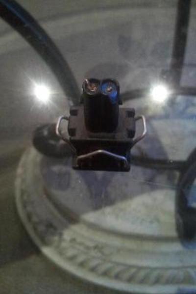

    The wiring to my N75 valve has snapped off inside the connector, i tried to push the pins out the other side (suggested on another thread i found) but they wouldn't move. Does anybody know where i can find a new connector or have one they want to sell?
    there's a special tool to release the pins, without that you will be buggered. easier to go to VW and get a new connector and they can also order the pins with wire already attached then you just have to slot them into the new connector and connect the wires to your loom via a crimp. A lot easier if you don't have the tool.... VDUB... Give your local parts guy the part number on that connector in the picture and from that part number the ETKA system will tell them what pins are required..
        Thank you, completely forgot about the dealership....i'll get onto them tomorrow then. Will driving the car around without this cause any problems? i'm guessing it won't, but better to ask someone who knows.
          I have the terminals for those connectors. $2 ea.

            apart from lack of power from the turbo you should be ok.. .
