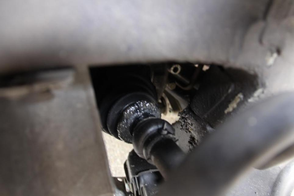

    So im guessing axles aren't supposed to look like this?
    Started when I was going to uni this morning as a knock when I changed gear/started and stopped. When I was on my way home it was a strange knocking/shuddering whenever I coasted but not when I was accelerating, by the time I got home it was happening when I was turning left, which is the side that picture is from.
    What exactly am I looking at? And whats it going to take (cost) to fix?
    Cheers

    Your axle boot has shat itself. Probably won't hurt driving like it for long, I've known people to drive like it for ages. Though sooner or later your CV will let go. have a look at this VWVortex.com - DIY - Blown CV Boot Replacement and inspection It might help!

      Thanks mate, does that fully explain all the noises?

        If its banging, clicking, clunking etc i'd say the actual CV joint has gone especially since its prevalent when turning. Time for a new cv joint or driveshaft i'd say.
          As stated the boot has torn and now the CV is stuffed.
          Had you noticed the grease earlier you may have been able to replace the boot and avoided the extra expense of a new CV.
          Basically the boot keeps the grease in and the dirt out, now that the dirt is in the bearings are dead.

            Thanks guys, any idea how much is a fair price for a fix??

                        -Booked my friend for next week, gonna use his workshop since I have no tools. Will hopefully learn a few things though and get a bit greasy.
                        And it may be because Im fairly low? also a good chance the boot has been broken for a little while, have been neglecting her for the last few weeks

                            They don't fail after a few weeks of the boot splitting. Low might not help but I'd expect that to reduce the load on the inner CV.
                            Gavin
                              Lowering can do damage to the outter ones, and will make the boot wear much faster as it rubs on itself
                              the inner CVs dont seem to cop so much angle change from lowering,
