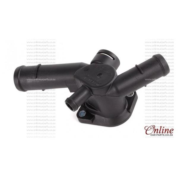

        Sorry VDUB for not being clear. It is indeed a 1.6L VW Golf GL.
        The ole flange leak... I haven't had a chance to look at the engine.. does it look similar to this?
          yep thats the one.. just have a look at the bottom edge of it..might need a mirror.. as justcrusin said ...look for dry coolant as your leak is minor...

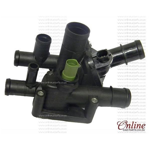

            I had a look at the engine this morning....
            I saw something that looked like the below picture.... does anyone have an ETKA diagram for the 1.6L engine?
              What's your year model and engine code?

                2002 VW Golf 1.6L
                VIN: WVWZZZ1JZ3W155418
                ENGINE: BFQ026377
                  Image shows a few things which may or may not be applicable, but it appears you can only order the flange as a complete assembly.
                  06A121111 for manual.
                  06A121111A for auto.
