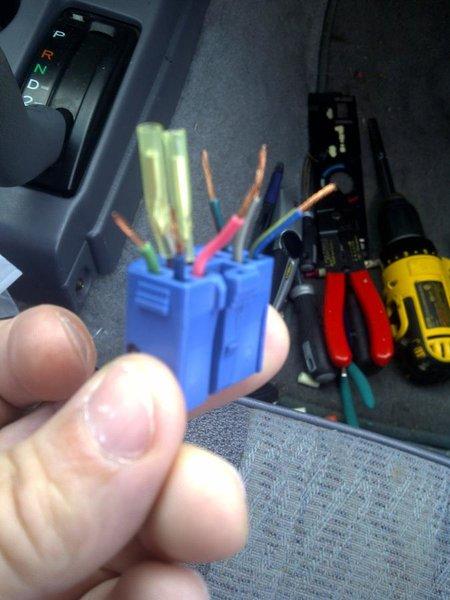

                        I used to run a couple of Strathfield Car Radios workshops for about 4 years back in the day and am happy to help out. To give the best advice, it's best if I see photos of exactly each issue..
                        Wiring harness: Aerpro are the main company in Australia that makes & sells stereo head unit wiring harnesses, see if they have what you want, they are sold in many outlets like SCR, Auto barn, Supercheap Autos, etc, and could order it in for you:
                        Harnesses - Car Audio Accessories AERPRO
                        Blue wires: There are usually 1 or 2 BLUE wires coming out of a NEW stereo wiring harness, which are for a) signalling an amplifier to switch on (the whole time the stereo is on), and b)switching on a small antenna signal amplifier (which only gives out a positive signal while the radio is on).
                        The only problems I've seen with using a wiring harness are usually just the two positives needing to be switched around sometimes. So the Yellow and Red wires, which are Constant Positive, and Accessories/Ignition Positive respectively. If your radio won't save radio stations or any other settings, these two wires need to be swapped. You can just pop the pins out, swap them over & pop them back in.
                        Also, the best method for keeping the wiring in place to put the original head unit back in is to just 'tap in' to the original wiring harness, don't cut it off. Then, when it's time to re-install the original Head unit, just cut off the 'new stereo' wiring from where it was attached to the original car wiring loom, and tape up neatly the stub of solder left behind..
                        Dark Grey Mk4 Golf, 1.8T GTI conversion, APR stage 1, stock air intake, FMIC, 3" to 2.5" Exhaust, FK AK Street Coils, Black 18" (Avant Garde M310's ?), tinted tails, ...
                          please don't use ****ty 'clips' like this... they will cause problems..
                          Bad tapping in, use solder & tape instead!:
                          You can use 'plugs' and if done correctly, are perfectly fine instead of soldering..
                            another method: you can always cut and solder the new stereo in, and then when it's time to re-install the original, cut and solder the original plug back on.. there's no shame in it.. it's hidden! But you will want to cut off the original plug so it has more wiring to play with when you have to re-connect it.. a bit more than this picture is desirable, maybe at least double that length..
