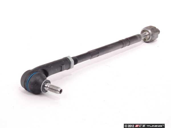

      In the parts list I just want to clarify some of the parts..
      Pair of Mk1 TT Steering Arms
      Pair of Mk1 TT Steering Track Rod Ends
      Does the steering arm and track rod end refer to a tie rod assembly like in this picture? Or is it something else?
