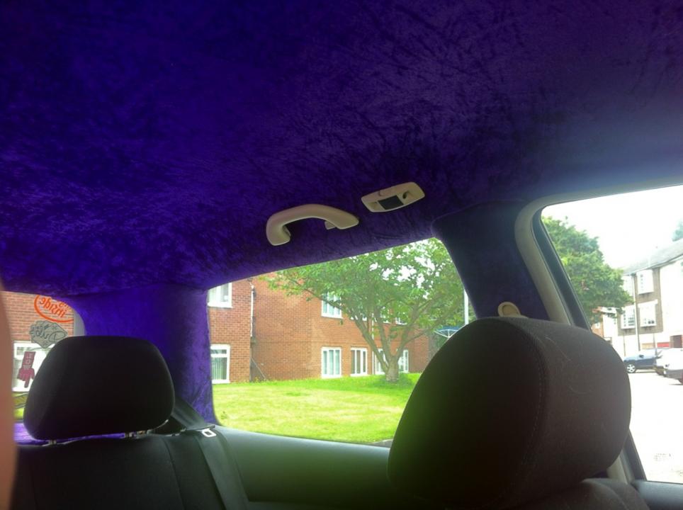

    hi i did a nice interior mod really changed the way it feels inside, and because i havnt seen many people do i thought id let you know how it turns out.
    Although i didnt get any pictures to remove headliner you take screws out all the interior bulbs and visors and the front a pillas just pop off and the middle ones you need to take the seatbelt off with a bolt.
    the rear ones same again take the seatbelt off.

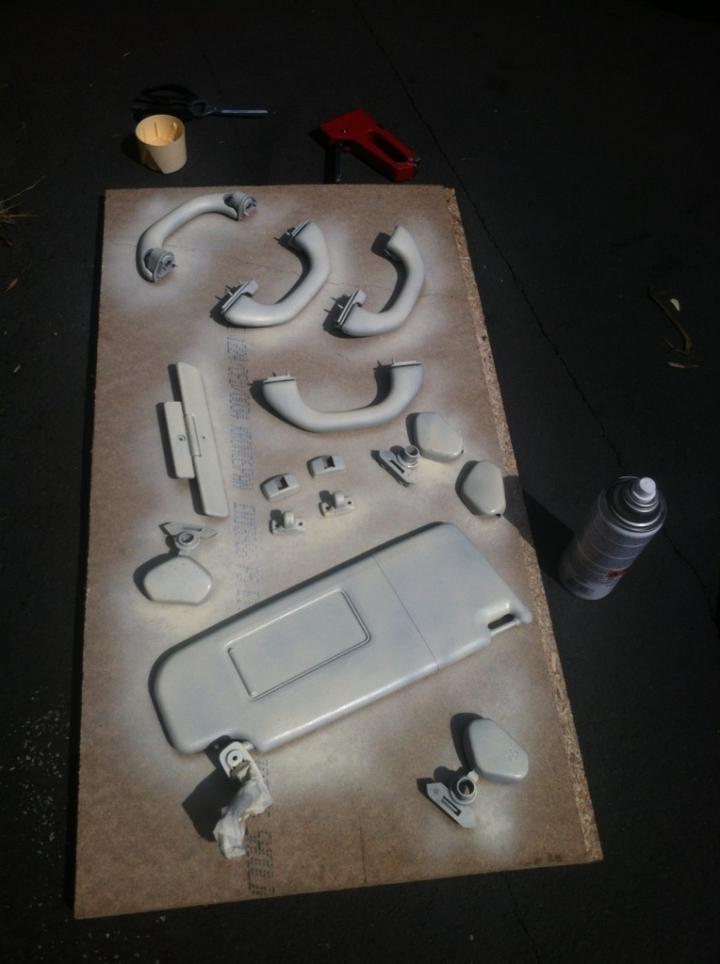

    so i did mine in crushed purple and painted all the bits cream

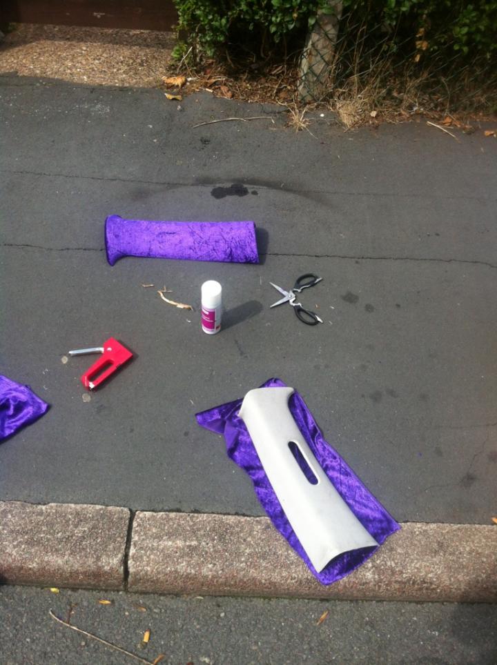

    start by cutting fabric bigger that the item your covering and glue it with Copydex. dont use spray as it sags in heat.
    then use a staple gun to tack it behind and stretch it tight.
    give your parts 3 coats of your colour

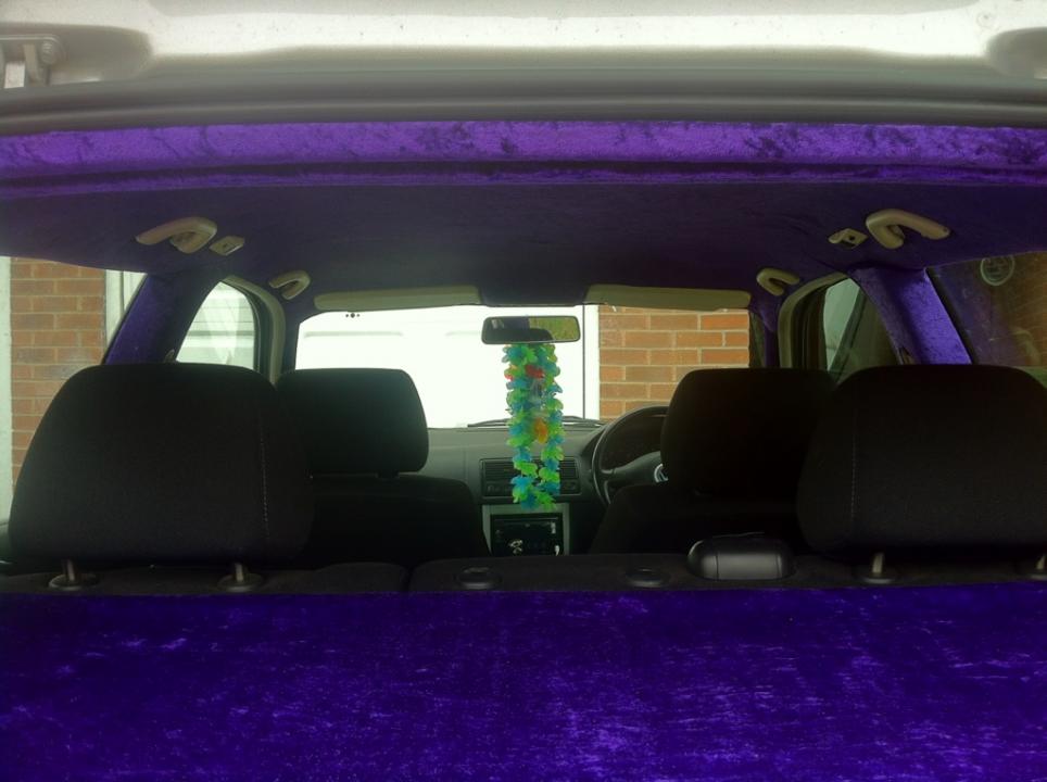

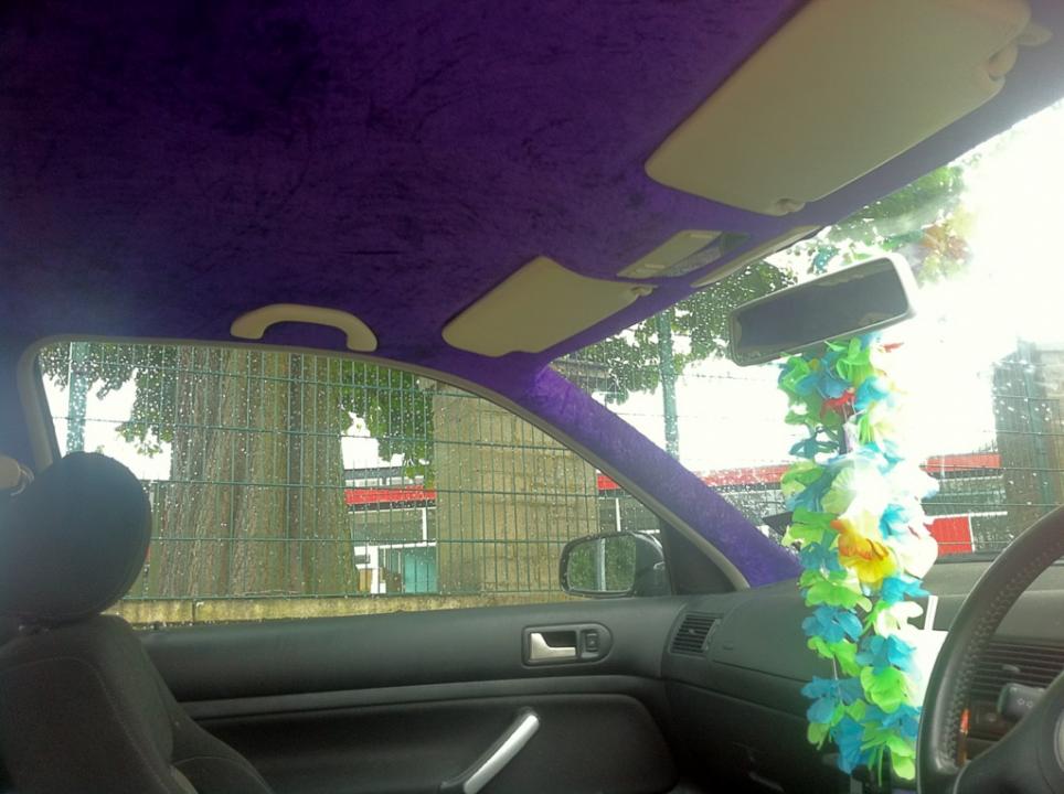

    then final result is this
