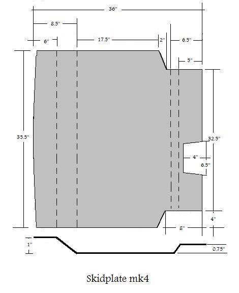

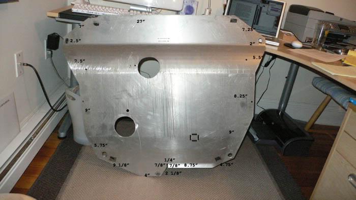

    lol at the roadsign idea , i doubt it would protect much from actuall scraping and such , also found this on the net if you have a lot of spare time, some tools and skills ? (might try it myself)
    and then theres this aswell

      • #33
        and then theres
        You'll need to fabricate a bar connecting both side of the frame to support the rear of the skid plate.
