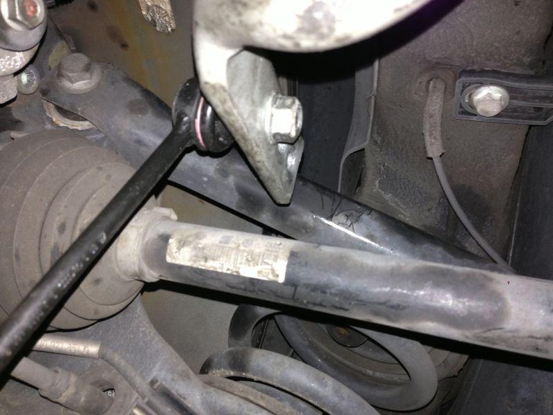

    Installed a whiteline 22mm rear swaybar into my 4mo Bora the other day. All went well until I could hear something banging everytime I go over a bump..

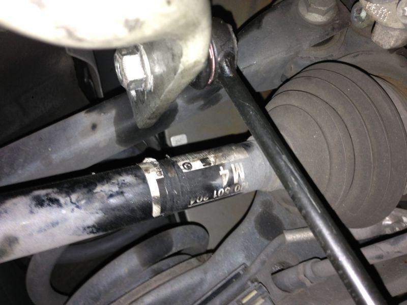

    The rear drivers side driveshaft is hitting the end of the swaybar? Doesn't do it on the passenger side.
    I've tried the swaybar on all 3 stiffness settings, and same problem everytime..
    Pulled the swaybar out, and re-installed to make sure it was in properly.. still doing it
    So now I have no idea whats going on
    Does anyone have any ideas? Car is stock height/stock suspension. Nothing appears bent or damaged
    Pics:
    Drivers side. Can see where it hits and has rubbed off the sticker
    Passenger side is perfect. not rubbing, no noise at all

    mine didnt do that .. is it the bar that's rubbing ? or is it the end link that's rubbing ?
    you may need an adjustable end link ..
    Volkswagen R32 MKIV 3.2 > Suspension > Sway Bar > ES#2497385 Gloss Black Adjustable Swaybar End Links - Pair - 108GRVBLK

      This might sound Capt Obvious but is the bar designed for 4Mo or FWD mk4? I've got a Neuspeed 22mm rear and it hasnt ever knocked, even with slight lowering.
      '03 Bora V6 4motion ~ CC Flash ~ Neuspeed F&R ARB ~ .:R optioned - Bilsteins,Springs,shifter,steering ~ Tyrol Brake kit ~ EVOMS CAI
        it's the only rear bar whiteline makes for 4motion boras and R32's as far as i know .. i have it in my car. . not a single issue
        VW BORA 2003 V6 4Motion
          FWD has a torsion beam rear end, so the swaybars are not compatible.
          Adjustable links sound like the go.
          Have you spoken to Whiteline about it?

            After pulling out the swaybar, it turns out its actually bent
            Pretty significantly too
            Gonna call the company I bought it off on Monday for a replacement. Hopefully it goes smoothly...
            Because there's no way I could have bent it. Gonna argue that it's a manufacturing defect or it got bent in postage

                      MRT Performance in Sydney who I bought the sway bar off were extremely helpful. I sent the bar down to them, and they forwarded it onto Whiteline. Received a call today from Whiteline saying they are going to make me a brand new replacement bar
                      Only problem is it'll be about 2 weeks due to easter etc. But still happy it was resolved with no fuss. Currently driving to and from work without a rear swaybar installed... such a boat around corners lol
