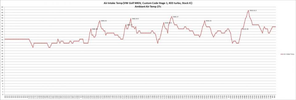

I thought I would start a thread with people posting up intercooler Air intake Temp Logs. A lot of people are wondering what intercooler cools the best.
I went out this morning to do some logging of my car. Ambiant air temp was 27 degrees celcius, humidity 28%.
Car: VW Golf IV GTI
Tune: Custom Code Stage 1
Turbo: K03
Intercooler: Stock
The car was well heated up before hand. I did 4.5 runs, WOT through 2nd and 3rd to around 6000rpm on open road.
As expected the stock IC would be average on the track, as air intake temp were 33 degrees above ambiant temps.
But still for stock I think that it pretty darn good! It was also interesting to note that the coolant stayed a rock solid 90 degrees.
Download the image to zoom in on the data.
Car: VW Golf IV GTI
Turbo: K03
Intercooler: Stock
