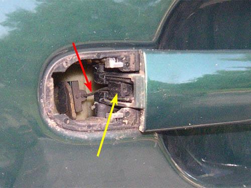

                    I had a problem in my car where I would pull on either handle and it would not open.
                    Anyway I took out the door lock, and there was a little grooved plastic bit that fitted into a grooved joint, I took it out and move it a few grooves foward and then my door opened and closed.
                    It might be something similar.
                    But follow the first half of this to take out the door lock.

                    this is what im talking about

                      Good photo - but how do you then pull the rest of the handle out of the door?
                      The manual says "Swivel door handle out of the door" but it's still captive
                      (I want to remove my door handles to carbon wrap them - nicely)

                          Here is a good thread with detailed pictures
                          VWVortex.com - DIY - Passenger Side Door Skin Removal
                          Looks like you have to pull the door handle backwards parallel to the door
                          I'm sure the workshop manual said to pull out/away from the door
                          Keen to try it tonight
