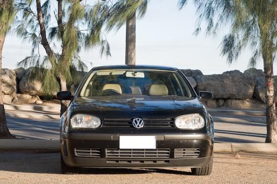

    She was a 4x4 with some pretty nice hubcaps... all I had done by this point is have tint put on the windows.

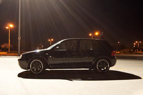

    Finally, got some wheels, and at the time I thought this looked the dogs, looking back now I can thoroughly understand why it's always better to lower first, then wheels. But that's what this game is all about right... learning.
    Finally felt gravity pull me to the ground when I could finally afford a set of coils for her.

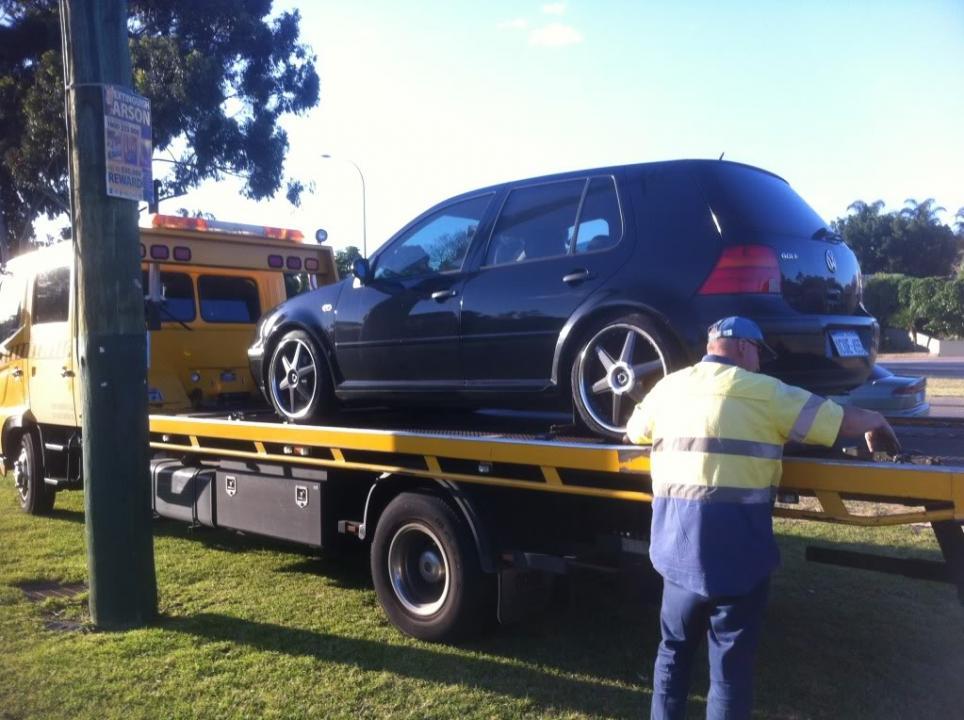

    The tow truck driver was a good bloke, knew how to have a laugh which was good. Always makes that painful drive home a little easier.

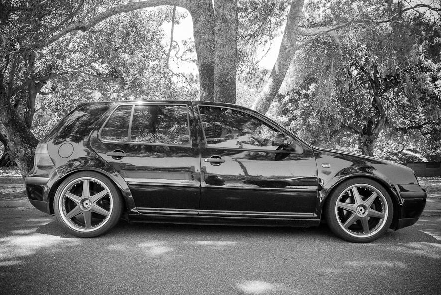

    Which brings us up to the present day, I haven't really done anything else to the car by here but when I parked outside Hyde Park I couldn't help but take some photos, it just looked, pretty good in my eyes.

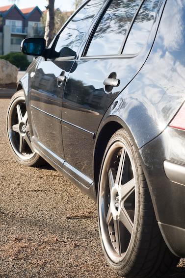

      Wheel offset etc.
      Car: VW Golf 2.0
      Wheels: Racinghart (can't remember model)
      Front: 18x7.5 ET.35 (after 10mm spacers) 215/40/18
      Rear: 18x7.5 ET.27.5 (after 17.5mm spacer) 215/40/18
      Fenders Rolled: No
      Fenders Pulled: No
      Camber: None/standard
      Suspension: KW V1
      That's in the last 2 photos those offsets before that it was most likely still et45 all round, which tucked a little bit more. With spacers they sit just flush with the inside of the fender lips.
