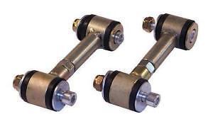

          or rather than change the whole sway bar, get longer drop links:
          use these:
          to replace these:
          search vw adjustable drop links on ebay, or ecs tuning have them

              How much longer are these mate?
