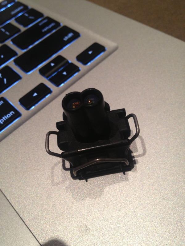

    Basically the wiring running to my n75 valve has broken. Which normally i guess you would just splice back on. Problem i have is, it has actually broken off inside the clip. Here is a pic
    Any ideas on how i can connect it again? I can't figure out how to pull the connection apart either.

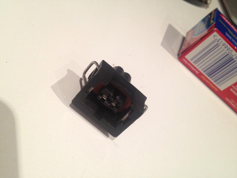

    The plug looks molded at the wiring end. Take a pic of the other side of the plug for me - i might have one for you with some longer wire.

      If you look in the front of that connector you will see the pins. If you poke a jewellers screwdriver or something like that down the gap. You should be able to push the pin out the back. Then you can get a wire on it again.

        thats what it looks like, so you reckon if i push those metal bits hard enough, it should come out the other side?
          You need to push a screwdriver( maybe 2) or something flat down the slot. This folds a tab out of the way and releases the terminal.

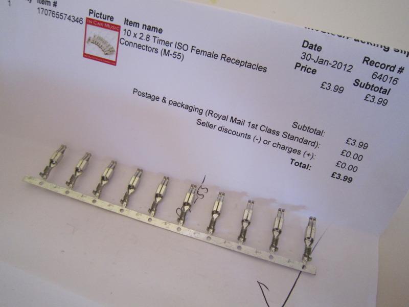

            a bit of a shameless 'plug' (excuse the pun) for my thread; have a look about half way down the page and you will see a photo of some speaker electrical pins. i'm pretty sure your pins will look like that once removed. in fact if you damage them i can probably flick you a couple in the mail, i'm pretty sure i didn't use them all but will have to check.

                hey mate, I did end up fixing it. I used some of the mrs's hair pins and pushed them in and then grabbed the wire from behind with some needle nose pliers and just pulled it out easy. whatever you use to push in the two holes either side has to be just the right size for it to release the connector.
