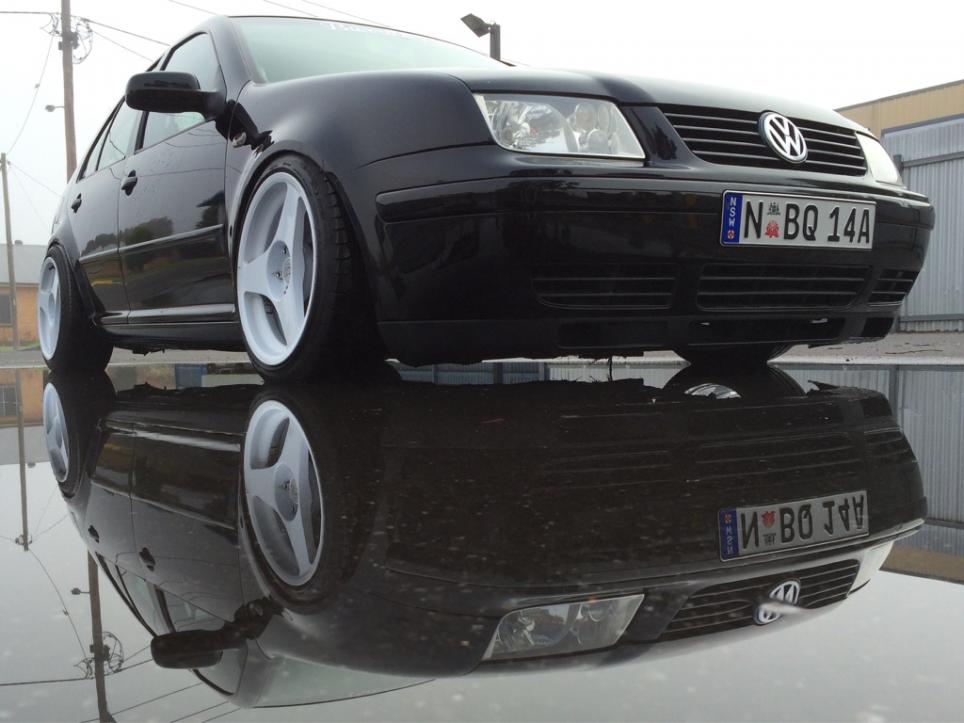

                          • Car: Bora V5 FWD
                            Front: 17x8 ET0 (after 35mm adapter) 205/45/17 GT Radial
                            Rear: 17x9 ET8 (after 27mm adapter) 215/45/17 Nankang
                            Arch height to ground Front: 24"
                            Arch height to ground Rear: 24"
                            Fenders Rolled: Front only
                            Fenders Pulled: No
                            Camber: -4 degrees in the front from R32 control arms and hubs and KMAC adjustable Camber Tops. -3.5 degrees in the rear from IDF drop plates.
                            2000 Black V5 Bora
                            1994 Charcoal VR6 Racecar
                            • better. may still need the centre bore altered and bolt holes drilled out.
