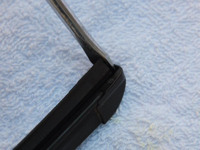

Step2: You only need to remove one endcap (jiggle each end of the wiper blade rubber back and forth and the end that doesn't move is the one you want to remove to get at the little tab/clamp holding the rubber) Remove the end cap by gently levering it off with a small screwdriver (If your end caps aren't coming of easily, don't force them, just dip the cap into some hot water for a minute and this will soften the plastic and make it flex off easily without breaking):

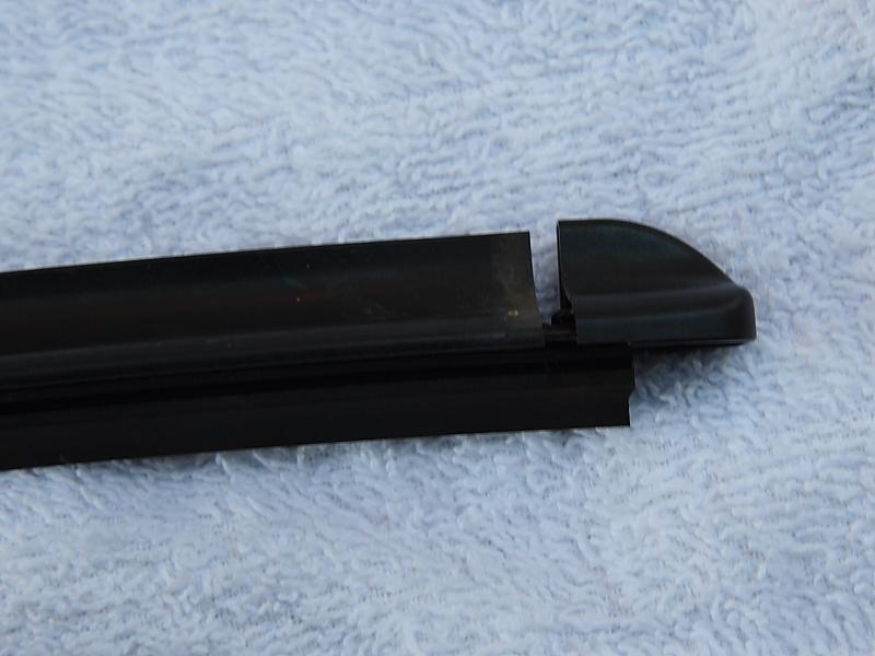

Separated end cap:

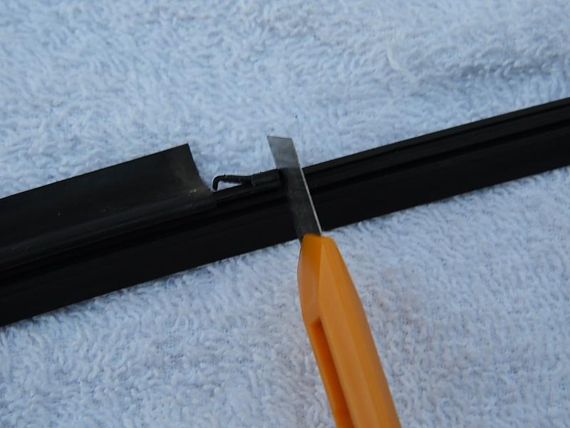

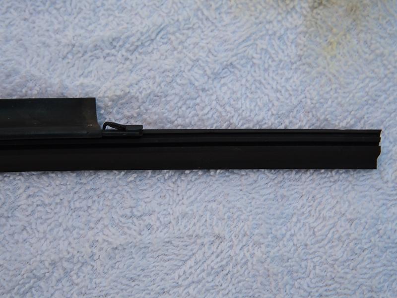

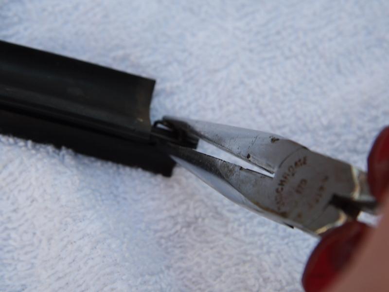

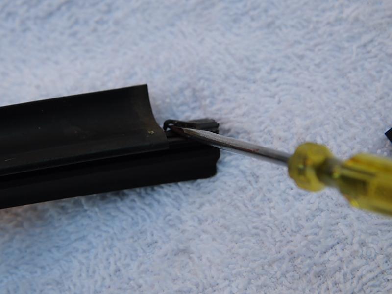

Step3: Here is a shot showing the little tab/clamp after the end-cap is removed, using a small screw-driver lever up the little tab/clamp releasing the rubber blade so it can be slid out:
