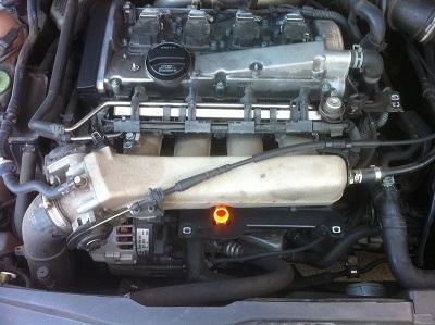

I was checking my oil today and while putting my dipstick back the orange pipe shattered. Panic ensued, but a quick search on the net revealed that it's a common problem that I'm sure most of you are aware of.

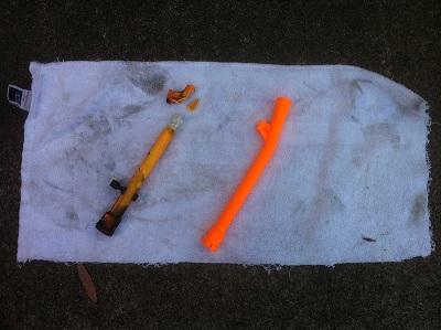

Went around the corner to the spare parts area and picked up a replacement pipe for $18 bucks. I took one look at the design and knew it wouldn't be a big job, so I headed back and jumped back on the net. Once my engine cooled down I set about replacing the part. It pretty much went like this:
1. Engine covers off, bracket off
2. Dipstick out

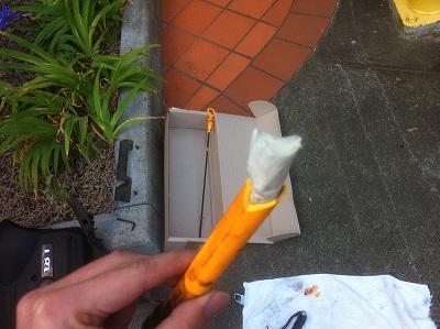

3. Jammed some paper down the old tube so any bits that break off wouldn't fall down there. Pulled the old tube out.
4. Installed new pipe by pushing it in, gave everything a quick clean and then brackets, covers, and dipstick back in.
