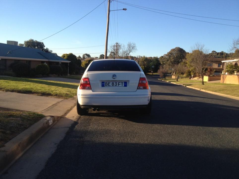

                    trickysimon with the white 4mo has the same brand coils as me (he has a 4mo, I have FWD) must be about the same height and he is stuck with next to no room to go lower, where as I have another 1-1.5" in the back to go down.

                      Rear wont go any lower than this:

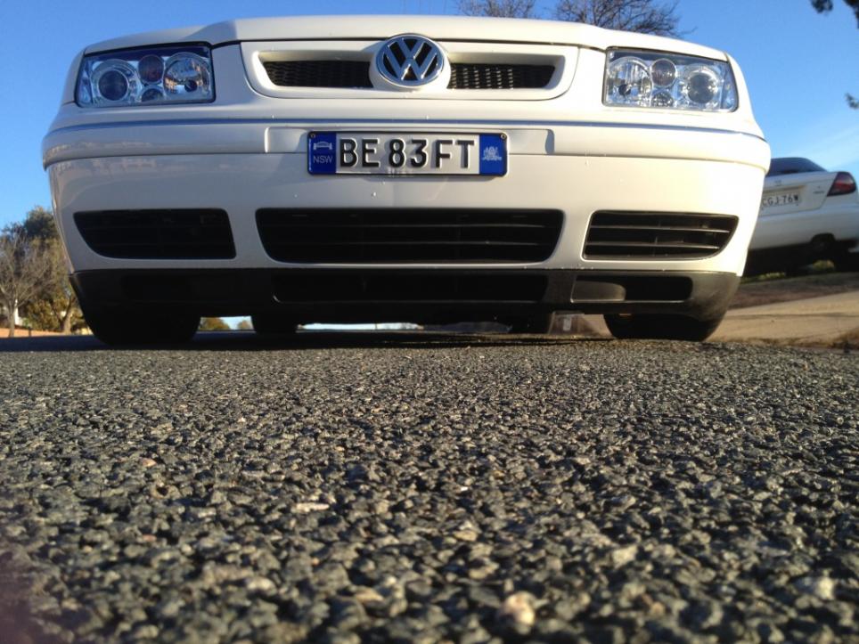

                      Where as I could prob drop the front another inch or so:

                        i have fk streetline's in my car they do a decent drop , never tried to max them out on lows honestly for the money they are great really bouncy at the start till they wear in a bit but after they are ok ( not the greatest but acceptable )
