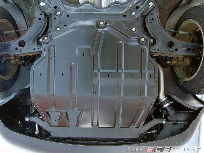

    Its about time to change the oil in the stupid 1.6, and the one thing I hate the most is stuffing around with the rediculously heavy skid plate on under the car.
    The poor 1.6L struggles enough as it is, yet alone hual around this aswell, must weight close to 20kg.
    Anyway the question is... does the 1.6L need this full body protection for a reason? Or can I replace it with the plastic flimsy GTI undertray as below...

    I'd take it off unless you are planning to drive off road. I will get better cooling too

      I removed it, no problems but the engine bay gets very dirty now

          Lets just say i could drive over a land mine and it would be fine.... no srsly... ts 2.8mm thick!! Guys in the states run these on their rediculously low dub rides to withstand all the speedbumps they go over.

            let me know if you want to get rid of it, last sump cost me $600+ to replace,

              I don't think the steel tray is standard. It must have been added aftermarket.
              The thing would cost around $500 landed in AUS.
              Not needed unless super low.

                I have a lowered Bora and a Diesel Geek Sumpguard - it is good on my car and hits around once a week over something... well scrapes, not hits, so I am glad I have one. It is Alloy though and about 5mm thick, but weighs alot less than the steel one. If it's not lowered I wouldn't think it's necessary - yours is definitely an add on - looks genuine vw, but would have been added - maybe it was an option the previous owner ticked - you can see the extension posts it's mounted onto with the rivnuts... You could probably sell it for a bit I'd reckon although a buyer would need to provide their own rivnuts which can be purchased from VW. Cheers, Scott

                    The pic is not his car, just an ECS stock photo.

                      Oh.... silly me... I was thinking about how it obviously has no scratches or hits, he obviously doesn't need it
