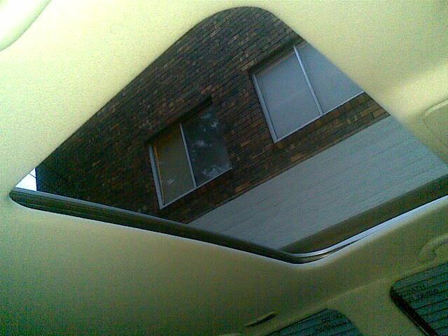

    when you open your sunroof, does it open like this:

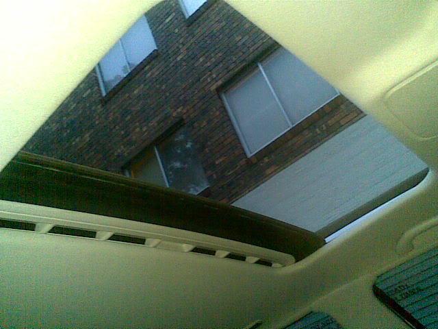

    or like this:
    mine normally opens the first way unless i play with it a bit. whats the deal?
    mine goes all the way in, 2nd picture
    if yours is like the first pic then i think its stuck!

      ah sweet cheers, yeah when i flick it just goes to the first position. then i have to push the grey cover in myself and then put it to the off position before it will go all the way in...strange.
        Hi Fuzz,
        The one on my Jetta opens like the first pic, never tried playing with it to open it all the way, just thought that's how it should be.

          As I understand it, the sunroof has 2 open positions. The first, when you turn it anti-clockwise and stop, is a "best position". If you continue to turn it till the knob stops, is open. Then, you obviously have the tilt option if you turn it clockwise.
            if i recall on my MK4, not only do you have to flick the switch to the open position, but then twist the switch past the 'open position' for it to go all the way like the second pic

                  i'll have another muk around this arvo because when i go anti clockwise all as far as the switch will go i get the first (not completely open) option. then i have to push the cover in myself and switch it back to the closed position, it will start to close and then retract all the way back in.

                      the first position is the recommended position for "minimum air flow interuption" or something like that. basically means that there will be less noise from air flow whilst it is in the recommended position. i always open mine all the way and to be honest i havent noticed any difference

                        Mines like this...i didnt even know it could open that far until recently!

                            ahahaha i thought i was the only one!! i was pissed when i saw that my sun roof only open 3/4's

                              turning the switch clockways has two positions towards the end,which stop slightly as you get to them.
                              first position stops alot of air entering causing a vortex and buffeting.second(all way) lets more air enter,but allows too much air to enter causing buffeting and alot of that woop woop sound.
