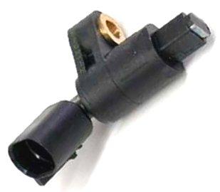

                I've had the early ABS engagement problem in my golf and I found a wheel speed sensor was not bolted in correctly. This was right after getting some work done on the suspension.
                Take the wheels off and have a good look to see if the sensor it loose.
                It is held in with a single hex bolt and sits really close to the wheel speed rotor. It is the funny looking disk with all the holes in it, it sits just behing the wheel hub.
                The sensor counts the holes it 'sees' and the ABS system works out if that wheel is about to lockup or not.

                        So, European Autotech said that the G-Sensor needed recalibrating, which they've done. This was causing the early ABS engagement.
                        Woo Hoo!
                        Bora 4Motion Sport | SAU Community
                          Just picked up the car, the sensor had been nudged forward when something was done behind the dash. Was probably me when putting the stereo in, doh! The sensor thought the car was on a lean to the front, so it was applying brakes early.
