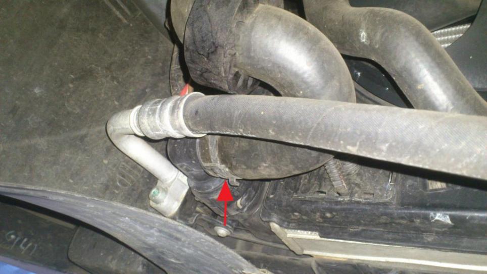

    Hey all,
    Went to change the coolant on my bora 4mo today but couldnt locate the drain point on the bottom of the radiator. Only thing i could thing to do was disconnect the hose as below and itd all drain from there?
    Is there something im not seeing or is that the way to do it? Sorry for the noob question im only used to working on jap cars.
    Cheers Curtis.
    Probably different on a 1.8t but I did exactly as you - took the bottom hose out. It's a bitch to get on and off and messy but it got the job done.

      Ok thanks buddy, yeah the only reason why i didnt do it straight away was to try and avoid the mess. Do you remember approx how much coolant the system holds. Be about 4 litres wouldnt it?

            im afraid you will have to go the hose way for drainage ..
            theres 2 variants.. some need a 9.4 Liters and some need 12 Liters .. best thing is to buy 5L bottle of 100% concentrated Red coolant ..

                  There's a drain tap on the bottom of the radiator on the passenger side.
                  Without having a bone dry engine/radiator, I don't reckon I have ever put more that 4-5 litres in a VW.
                          cheers gav, but i couldn't see it. Prob because the bumper cover extends so far back under the radiator .... the Youtube vid where the guy does it doesn't seem to have this undercarriage plastic cover... see: DIY: Volkswagen mk4 jetta/golf/gti radiator flush part 1 - YouTube
