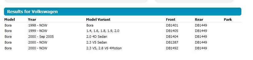

          It's probably DB1401 could also be DB 1405, take the sample with you or take the picture of your old pad. I use DB1404 in my T5. I've done almost 30,000km on them and I can't see much wear. Great pads, almost no dust on the wheels. Highly recommend Bendix GCT.

            Yeah I went and had a look. It looked like its either db1405 or another one that looked very similar in size. Can anyone confirm for me whether its db1405?

              The p/n's I quoted you are from Bendix on line catalogue, they're usually accurate.

                this is very misleading
                my cars a 2.0 2002 model. According to that db 1401, 1405 and 1404 will fit!
                Clearly 1404 were wrong

                  Yes, you need to take the old pad with you or at least the picture of it, simle enough.
                  Alternativelly, go to the dealer with your VIN and they give you the right pads for your Bora.
