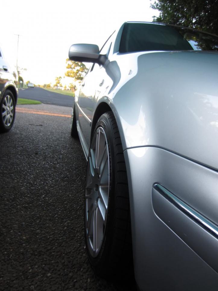

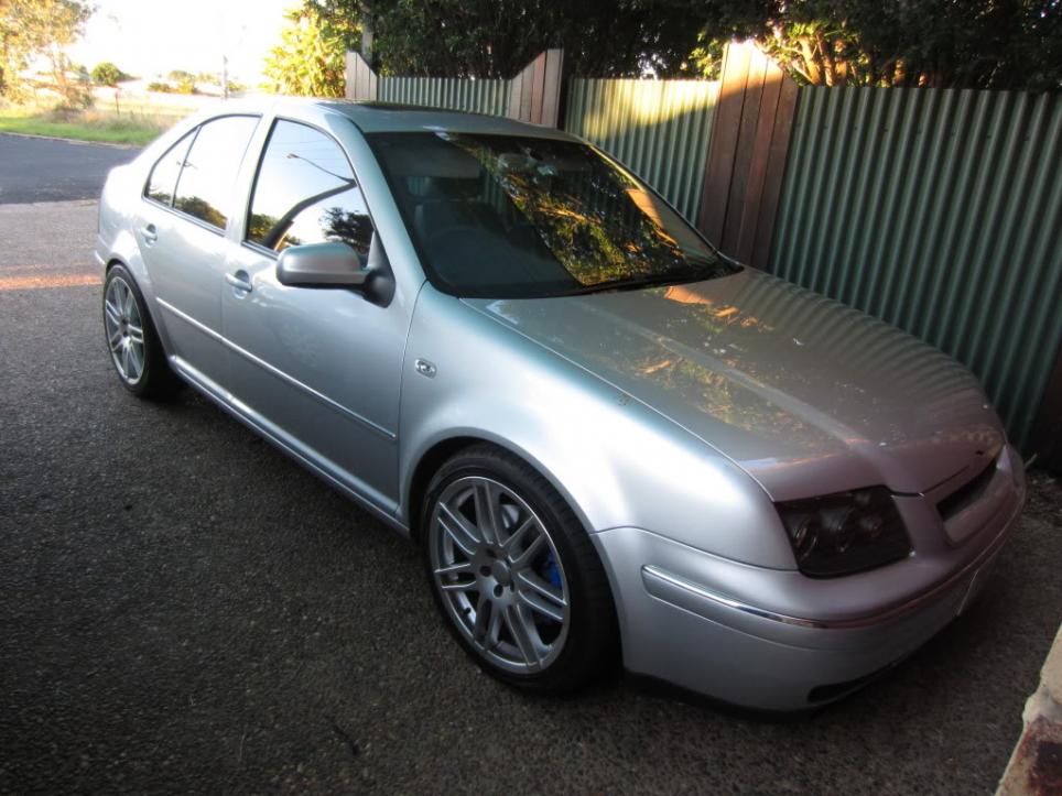

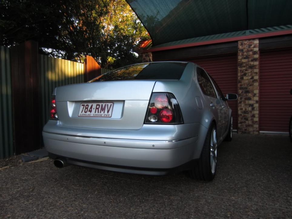

    Here's my Car... I have it lowered on Eibachs, Whiteline Swaybar - Rear, CAI, Sports exhaust, my controversial Subwoofers, a Double DIN Pioneer headunit, RS4 REP Wheels, Diesel Geek Sump guard, Angel Eyes Headlights and Depot Rear lights, debadged boot and Grille and Boser Bonnet in bare primer stage... not everyone's cup-of -tea, but my Son (15) and I like working together on it...

            On another note, your shaved trunk looks good (Y)
