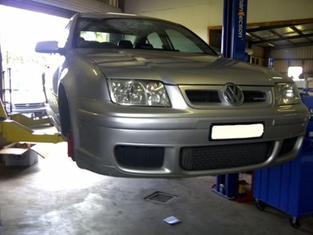

    the r32 bumper seems to sit a lot flatter at the front than the standard golf or bora one rather than angling back in at the bottom if that’s what you mean
    i had a similar issue plus hated the standard bora bumper, depending on how much you want to spend what I did was buy a cheap r32 replica off ebay and got a panel beater to splice my bumper to the r32 bumper. The issue you will have with the r32 bumper is it doesn’t have rub strips like on other golf’s and boras so it will look odd if you don’t replace your back bumper then – unless you don’t care (plus i happened to like the look of the rub strips)
    also doing this allows you to make the bumper go a bit lower (although a driveway nightmare) getting even better coverage of any cooling pipes and the intercooler and gives you the advantage of a lot bigger intake area on the r32 bumper for cooling the FMIC

    Here’s the finished product
      Thanks mate - thats exactly the info I was looking for! Will keep my eye out on ebay
