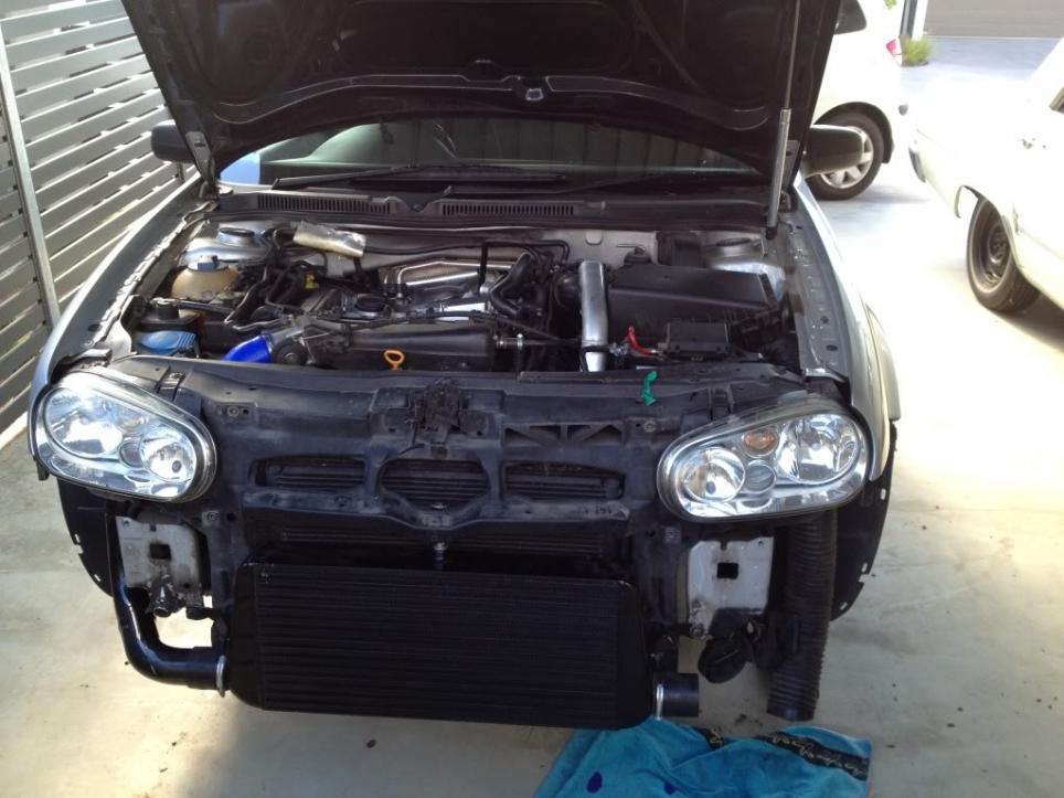

    This is how it looks currently.

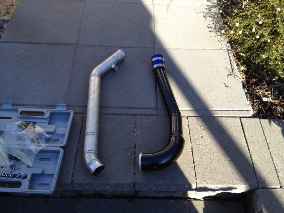

    On the driver's side, the black pipe ran perfectly from the FMIC to the intake mani. However, on the passenger side, I'm struggling to work out how/where to run the pipes. These are the two pipes I have left.
    I'm pretty sure that I'll need to get another section of pipe to run from the turbo up and across a bit to meet the non-painted section of pipe. Then it looks like the non painted section will run down alongside the battery, and at some point meet the section of painted pipe. The problem I'm having is that the section of black pipe really doesn't seem to have the right curves to get to where I think it should be going.
    Have I missed something really obvious? Has anyone got any photo's of their FMIC install which show the plumbing on the passenger side in more detail? Does anyone have any suggestions about how I can run those two pipes to get close to the back of the motor.

    Aussie mk4s gtis didn't come with a map sensor. as for the piping, this is how mine is routed
    it looks you may be missing a few bits of pipe as i can't see how that would work. If you want i have a spare set of pipes that you can have if you can't get these to work.

      Hey, thanks for posting those pics! I'm definitely missing at least one pipe... It looks like the pipe for the hot side which has been painted black that I have just wont work. It doesn't curve nearly enough...
      Yeh I'll definitely refit the rebar... Once I've trimmed it. I was hoping to route most of the piping before worrying about making the rebar fit.
