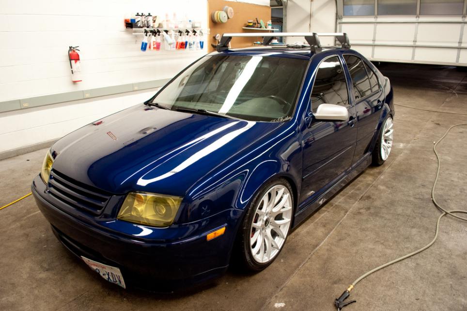

    In return, the sexiest Bora I've seen (IMO)

    My Son had exactly the same problem with his 4 motion Bora after recent heavy rain, rear footwells soaked. From the photo i'm assuming you have a sunroof and the drain channels become blocked over time. You can get VW Service to fix the problem, which is what my son did, or if you want to DIY there is info on the internet detailing the procedure.

      That's not his Bora ! But if there is a sunroof that would be the 1st culprit.
