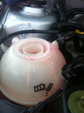

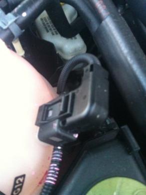

    Hey guys I've had my coolant light come on a couple of times in the last 2-3 months (today being the most recent time) and I'm wondering if there's anything I should check? I've taken a few photos showing the coolant bottle with what looks like dried up coolant (may be my terrible pouring skills though haha) and also a part that was a little but loose when I had a look a few minutes ago

    As the coolant is red, you should be able to see where it is leaking if it is leaking externally. Look for red stains below any of the coolant hoses.

      looks like the cap isn't holding pressure once its hot, i had this happen a while ago and this was the problem . replace the cap and see how you go

        Ok thanks for the suggestions guys, when it happened the first time I put newspaper underneath it overnight (I don't have a decent jack haha) and there wasn't anything under there and I haven't noticed any leaks... But will definitely check the cap first haha

            Does it happen when you first turn on the car ?
            If so you probably have a slow coolant leak. When you first start the car the coolant cold and is too low and sets of the low level warning. After a bit of driving the coolant heats up and expands, lifting the level over the warning point and the light goes off.
            There are many places it can leak. Basically at every hose connection or plastic part. I had to replace the tee where it meets the engine block, it had cracked, another hose went once too.
            The Germans do not know how to make plastic like the Japs.
            Plastic waterpump = fail, plastic window regulators = fail, plastic coolant junction = fail.
            To find a leak look for dry coolant it forms a pinkish white powder and generally dries right where is it leaking.
