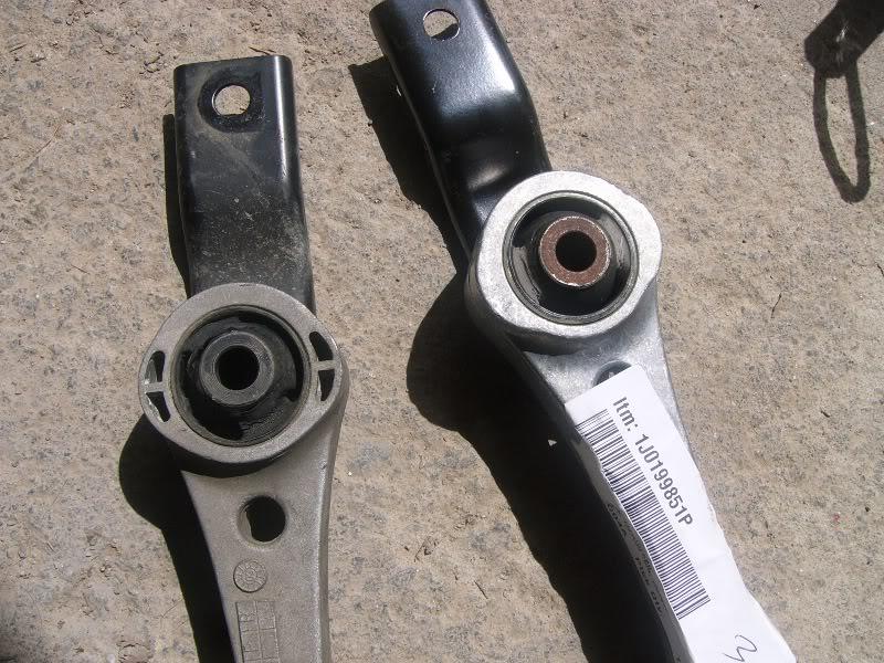

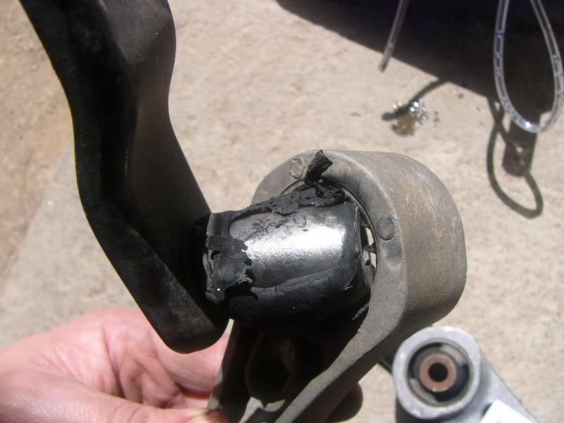

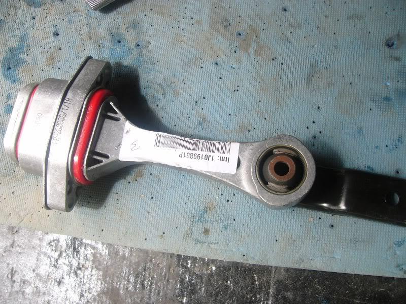

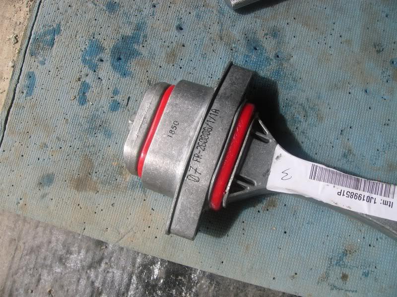

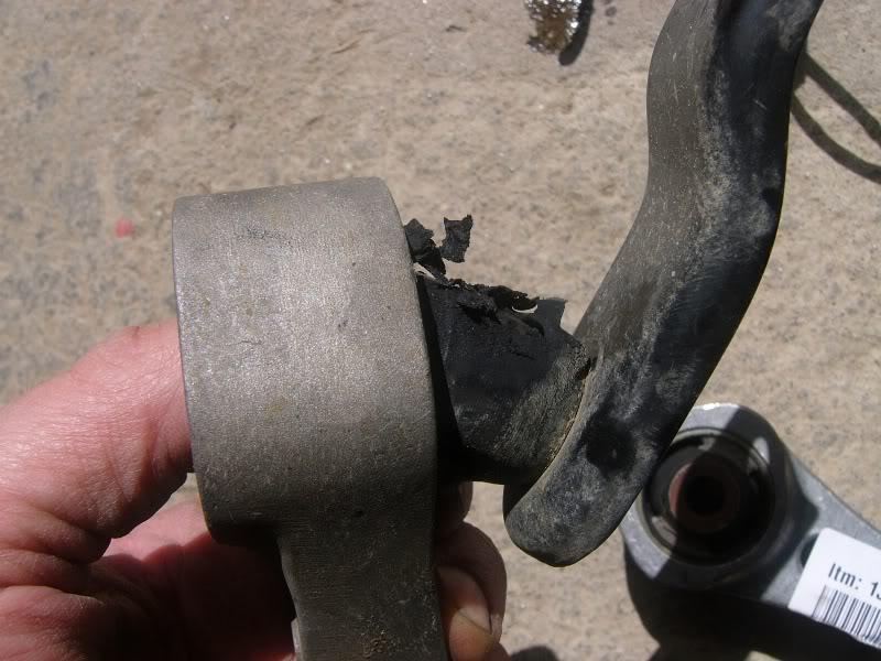

    My pendulum mount wahad a flogged out bush so I rel=placed it and upgraded the big end bushes to urethane.
    Most likely the excessive wear is due to me towing heavy things.
    Easy job. obviously less backlash in drive train now. Very responsive to accelerator input and a lot less clunking when letting the clutch out!
    Pictures! Everyone loves pictures!
    Old on left, new on right.
    Prothane inserts. No noticeable vibration as a result.
