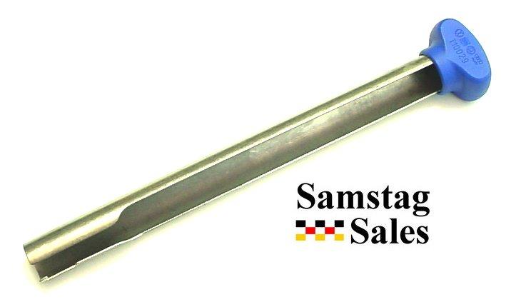

    So I searched the interwebs and I found people using the following tool to remove the 'metal extension' things ontop of the plugs:
    It seems to be used for changing the plugs on a vr6, but people are saying you need it for the 1.6L aswell. Are there any australian sellers? Is the T10029 the right tool for the 1.6?

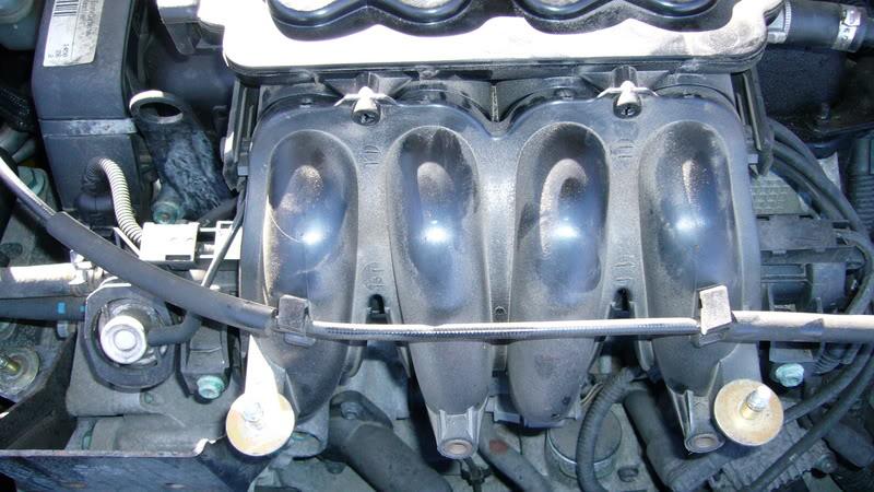

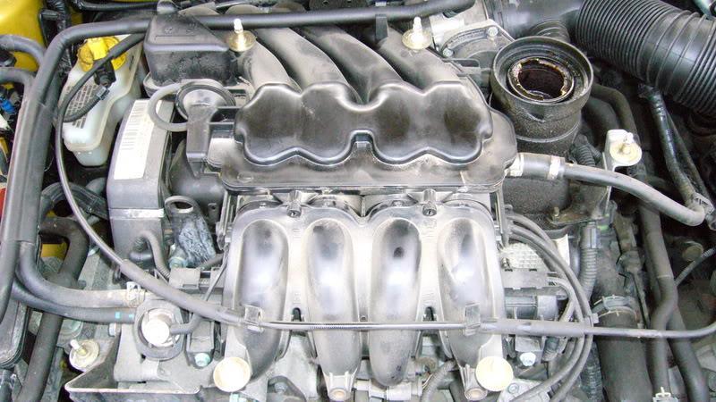

        Here are some pictures of an engine similar to mine:
        Then the front of the engine from a diagonal viewpoint:

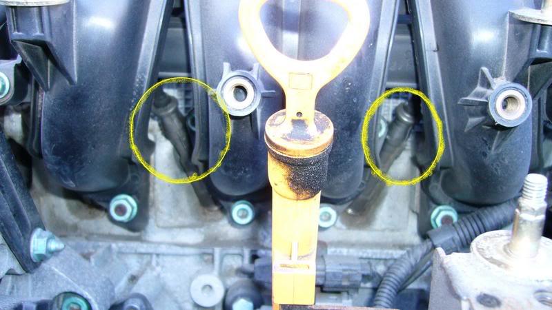

        Then the front of the engine with 2 sparkplugs circled:
        Ill attempt the technique described by craig the german as we are talking the same engine Im pretty sure.. Thanks for the help everyone.
        If you could identify what other plastic things to remove that would be great.
