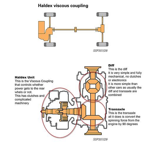

Here is my understanding of the setup of a Bora 4motion, feel free to correct where I am wrong (I'm used to it, I am married)....
It seems that a lot of people, including mechanics, use the word 'diff" when talking about the Haldex. I think this is partially because the Haldex is bolted to the diff housing.
The Haldex is a Viscous Coupling and contains clutches, but it is a totally separate unit from the Transaxle/Diff that the Haldex is merely bolted to. The diff contains no clutches, it is just a regular diff similar in concept to what you would find in any Commodore, Falcon etc.
In theory you could unbolt the Haldex, install a longer driveshaft connected directly to the transaxle and have a permanant 4 wheel drive system (well, it would be permanant until you drive it around a few corners and the transfer case blows up)
Here's a picture I knocked up in photoshop from a layout of an Audi TT..... (please don't think I'm trying to insult anyone's intelligence here, I know that everybody knows at least 90% of what this picture shows, if not more, I'm just trying to clarify my thoughts)
