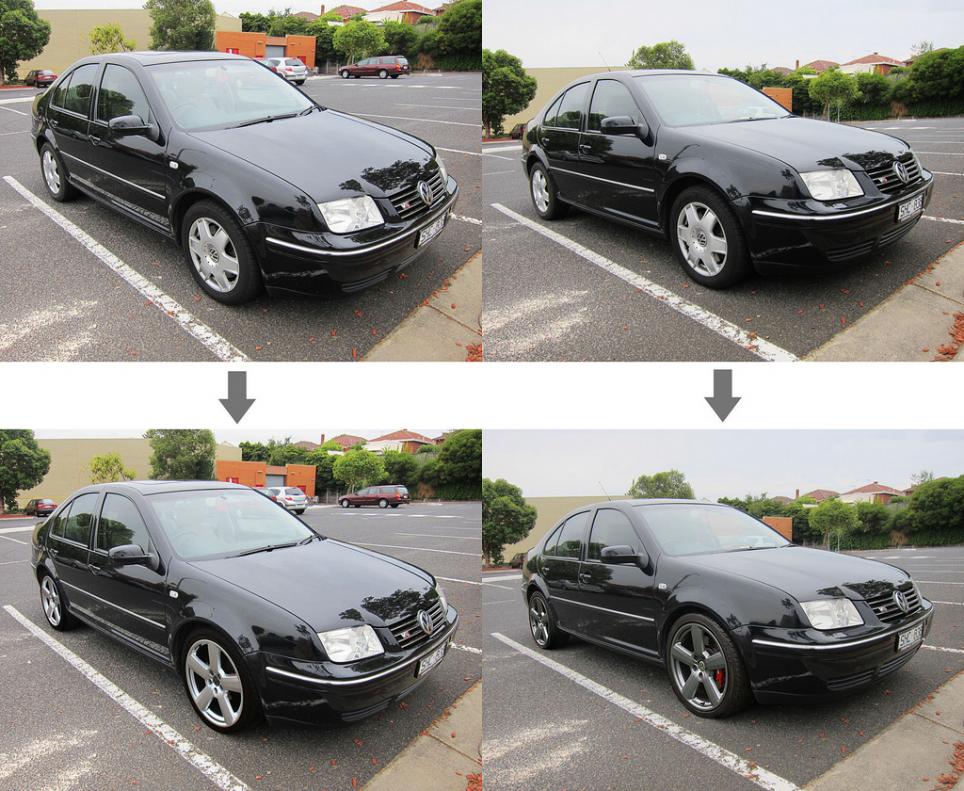

    My Bora V5 comes with the beautiful 6 spoke Le Castellet stock wheels, I love the design very much. However, its 16inch size is about 1 inch smaller than what I would like them to be.
    But I can't find any 17inch or 18inch replica of this design, so I'm thinking of changing the wheels to 17 or 18 inch Audi RS6 Replica wheels. I've done some Photoshop to see how it looks like.
    Have anybody done this before? And what specific dimension should I be looking for when searching for these wheels?
    Looking good. You want something like 18x8, offset of 35, centre bore of 57.1, 5x100 stud pattern, and for that size wheel a 225/40/18 tyre.
