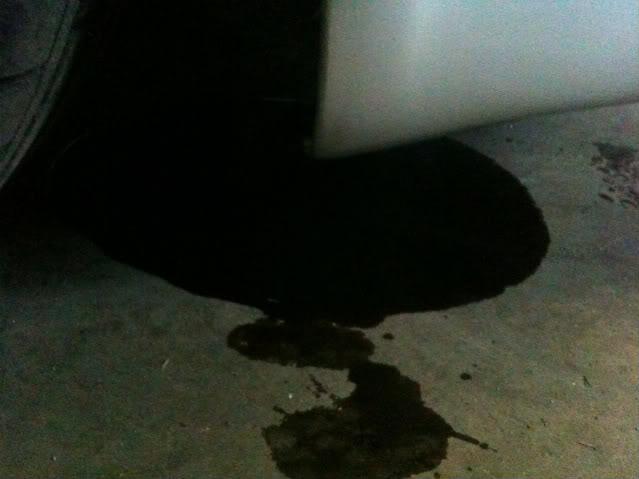

                                Heres what happens without the oil drain back mod
