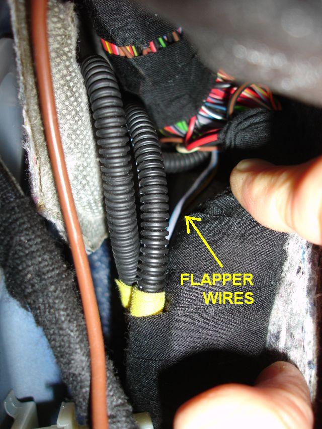

          Firstly, on the Aussie R32 the two wires are pretty well separate from the main harness in the passenger lower A pillar and are right next to the corrugated tube that runs to the back for the vacuum flapper (vacuum "supply" tube)
          Secondly, there is also another thinner grey/blue wire that people sometimes cut in error, but that is actually in the main harness on ours.
          The wire we want is right next to the yellow/black wire (which is the other wire running back to the solenoid). Both these wires are 1.0mm², so quite thick compared to some others in harness.
          The grey/blue wire is actually the earth from the solenoid. The ECU earths this wire when it wants the flapper to be quiet.

            There is no change to the system at all (kicks in at 3000rpm and speed >70kmh) - however I need to reconfirm wire location for the non earth wires as the position described is different to where the kit was wired (from memory).
              This is the RHD wire position in passenger A-pillar behind kick panel:
