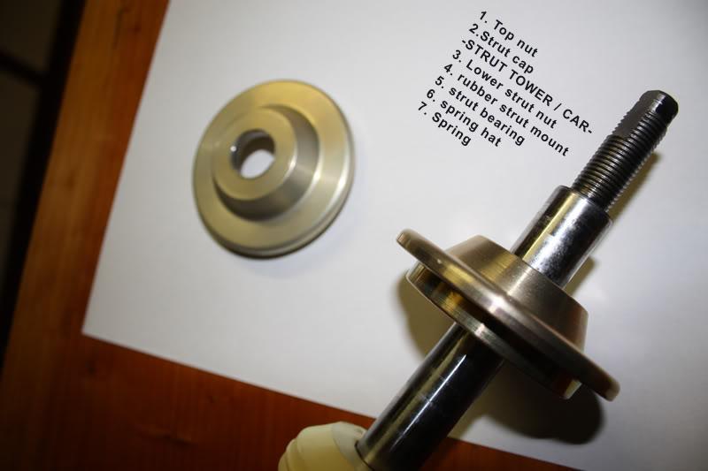

              Just to check, this is (from memory) how I assembled the components of my struts in the front:
              Note that all items down to the strut bearing should comfortably sit on the section of the shock with thread. I originally had an issue with my spring hat not having a large enough inside diameter and not allowing for all components to fit properly. After I fixed this, all parts could be secured onto the thread and there was much more thread left on the end of my strut than the image you posted above, even in the car and including the strut cap. Are both spring hats able to more up and down the shock body without resistance?

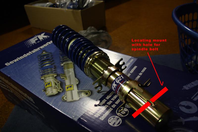

              As Jimmy also said, did you get a picture showing both struts side-by-side? I wouldn't think you could stuff up seating the shocks into the spindle as there is a locating bolt on the back of the spindle that tightens the spindle, while also allowing for this bolt to pass through the shock's mounting brackets (my standard and coilovers both had this), meaning it was impossible to incorrectly locate it. Do your new shocks have this feature?
              Here's what I mean:

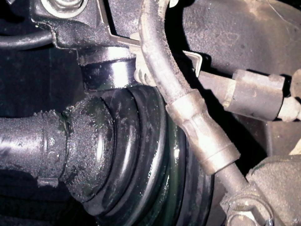

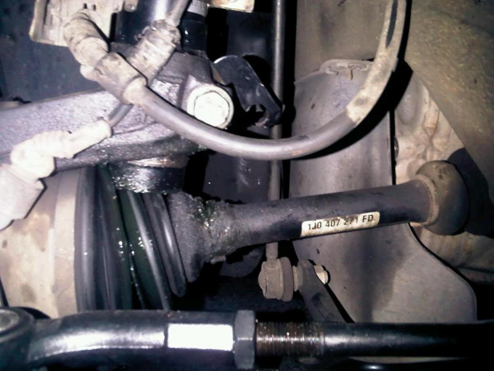

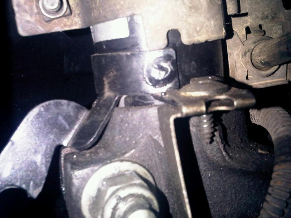

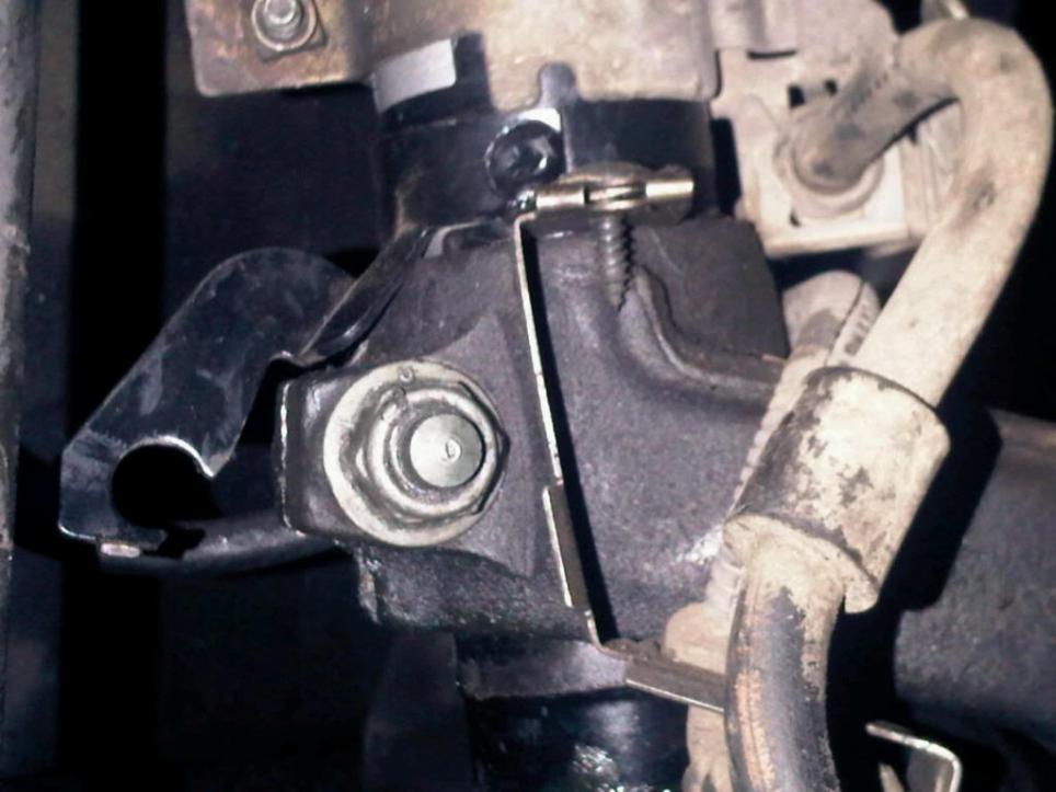

                              • #30
                                Pics added
                                OK, took the rim off to take pics to show damage to boot, depth of strut base and the angle of the bend (potential damage?) of the strut bracket.
                                Taken from a Blackberry camera on autofocus and close focus, so not the best.
