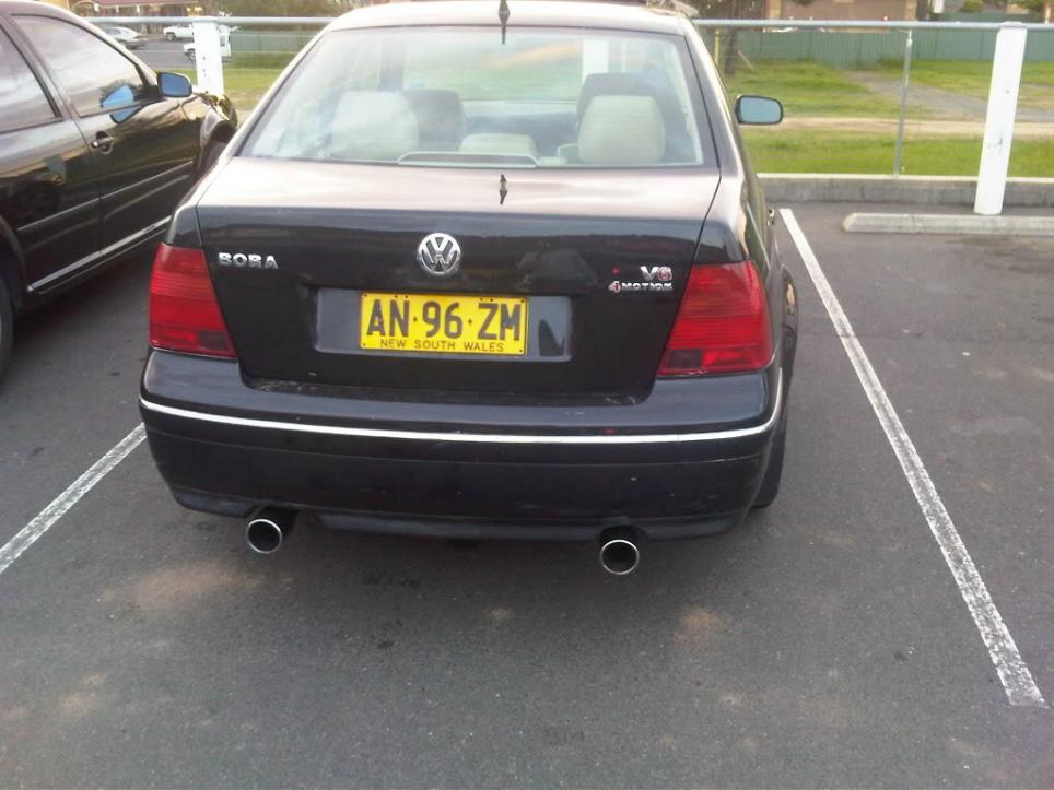

                its fitted, and looks awesome. here's some piccies
                the sound is a different story. I had high expectations, as i guess anyone could figure out from me being so excited. I knew the 3.2L versus the 2.8L would always produce a slightly different sound (deeper for a R32 i'd be guessing) but figured i'd get the same burble and crackling on the over-run. I don't think thats the result i got...
                I am fairly sure the flapper is tacked open, but need to take a pic and confirm via here. on start-up and revving (1k rpm to about 3k rpm) everything is quite R32-like and awesome. evil-ish burble and throaty. but after that it sounds similar to the stock unit.
                Inside, quite surprisingly, there is no change. yet to do a proper bum-dyno test. maybe can sense a bit of a "Vring" in the midrange but very much like the good ol' Bora - not such a bad thing. No reportable drone at all, and i covered all speeds. tyre noise is actually more annoying than anything.
                Need to post video.

                  Its dirty.. clean it!
                    And use two hands on that camera!

                      all in good time. dirty things are good too
                        that was my crackberry - takes surprisingly good pics.
