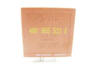

                Looks to be part 4B0955531E
                It should be on the relay carrier under the steering wheel.

                  ah thanks for that. under the steering wheel is it, guess if i take of the lower dash panels i'll see it?
                  and where'd you get that p/n from?

                            just called up vw parts. $87 for the relay. ouch! and it's on a 3 day back order from singapore.
                              where'd you get that part number from?
                              i searched and found it on ECS who say "Fits vehicles without rain sensor wipers only."
                              Audi B5 S4 2.7T > Search > 4B0955531E
