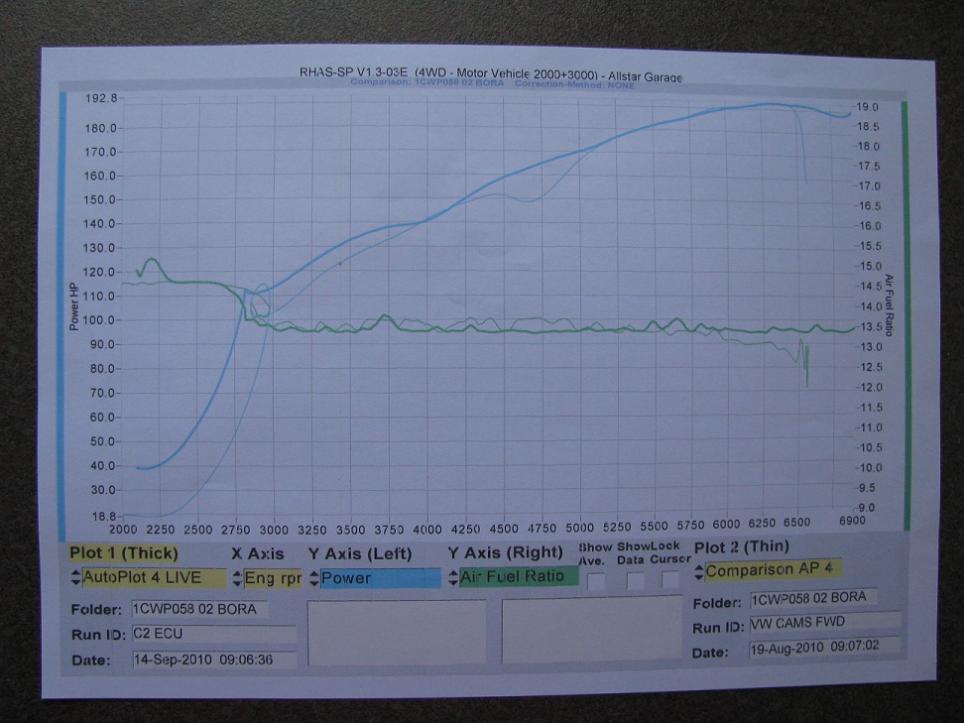

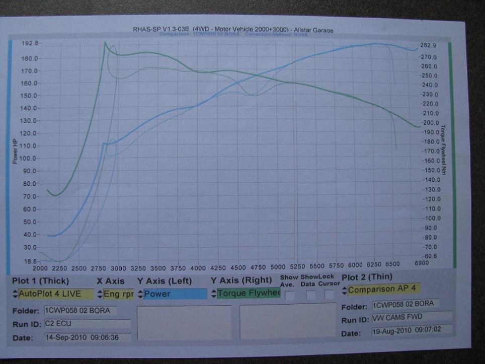

    Had the car on the dyno again today after swapping in the C2 (cams + high flow cat) tune.
    Car has the following mods:
    BMC CDA intake
    Cat back exhaust (2.5" resonator, to 2.25" rear muffler)
    TT Cams
    Previously, the car had a flash from a company called Superchips, so this comparison is vs another tune, not the standard ECU.
    Here are the results:
    Torque:
    Air/fuel ratios:
    A quantifiable gain in low end torque, and smoothing of the mid range dip that I had previously, as well as the increased rev limit which will help on the track.
    I also feel that the throttle response has been sharpened with the DBW too, but this may just be my mind.
    I am considering now doing high flow cats and a bigger exhaust to try and crack 200hp, but not sure if its worth it.

      Thats awesome for NA power
        That's power at the wheels? Impressive, given that's near enough to the stock engine's flywheel power figure...

            yeah thats power to the front wheels.
