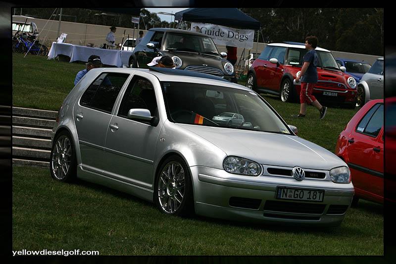

                    My 18x8 ET32's sit pretty close to my KW V3's. I doubt I could have ET42's with my setup.

                        It's more of an issue with the strut. My car is set to the higher end of adjustment.
